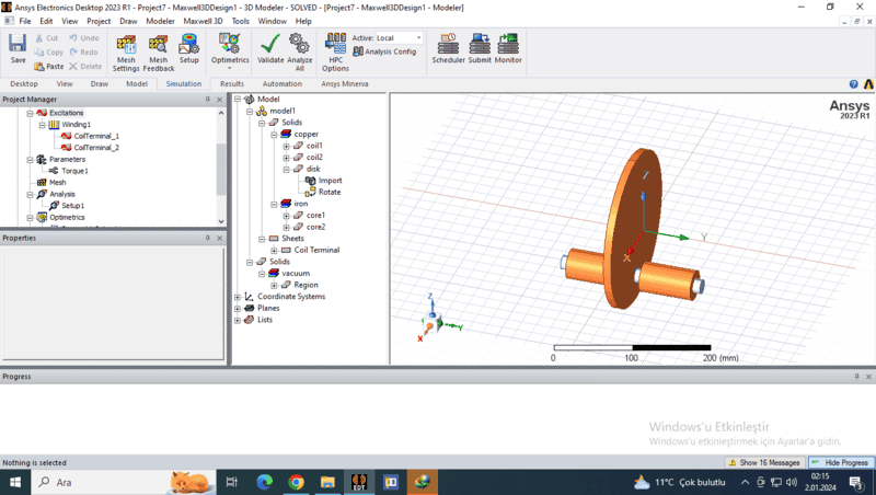

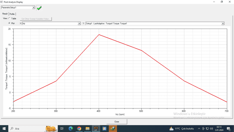

Hello everyone
I simulated the eddy current brake of 2 1000-turn coils with 5 amp excitation in Ansys Maxwell, but the torque fluctuates. How can I overcome this problem?
If you want to see it in more detail, you can download the project from the link.
(Sorry for any language errors)
Is the brake disc mechanically vibrating? If so, make it stiffer.
The disc rotates from its center, I don't think there is anything that could cause vibration.
Since it's a simulation and really rotating from the center, then it must be a numerical error.
Try smaller time steps (probably the easiest).
Also, the disk diameter may need to be either an odd or even multiple of the grid resolution; depends on whether the software treats Points as vertices or centroids.
