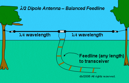

Do you have a picture of such an antenna? If not, can you use Google Images to find one?
Does it look like the folded dipole suggested by @NascentOxygen ?
Or could it just be a Balanced Feedline to a dipole antenna?
http://4.bp.blogspot.com/-E7_DNGw_UgA/UFxWVfdGaRI/AAAAAAAAABw/Tq492Jf4S-o/s1600/Dipole-Ladder.gif
Likes dlgoff, jim hardy and NascentOxygen
The picture you quoted is indeed nice. But I do not understand what is the feed-line for? Why do they need a feedline of that peculiar shape?
The feedline needs to have an impedance that matches the characteristic impedance of the antenna (and also the output impedance of the transmitter), so energy is not reflected at the junction. The horizontal lines represent plastic to keep the conductors at a fixed spacing. Parallel conductors spaced apart is typical of 300Ω impedance, whereas coaxial cable is used for 50Ω or lower. If unequal impedances are used, a transformer is needed to transform the impedance so feeder and antenna appear matched.
1. The picture you shown is not only parallel lines. There are some spacers? Is that only spacer which has no function for the line?
2. My interest is in the antenna instead of the feedline. An antenna of the ladder shape. Will it has better performance? Has anyone studied such antenna?
The spacers are plastic, and are referred to as the dielectric. They give the transmission line important capacitive characteristics.
Almost anything can be used as a radiating surface. Two long thin conductors joined by many short thin conductors would be electrically the same as a single long conductor, at long wavelengths. At shorter wavelengths it almost certainly would have been experimented with, radio experimenters have been a very enterprising breed of hobbyist, but unless it were found to offer advantages that other simpler lighter shapes don't, then it would have been discarded. You say you have found a photo, but I'm still waiting for the link. In photos it is often difficult to distinguish conductor from insulator, e.g., aluminium tube from PVC pipe joined to the aluminium.
The Sterba and Bruce antennas look like ladders.
DNA cannot be an antenna because it is a twisted pair. The radiated fields will tend to cancel.
I seem to remember a similar question about making a dipole array to emulate chlorophyll. Chemistry is really an infrared technology with some coloured visible light effects where metals are involved. That cannot be analysed as waves and dipoles but must be analysed using quantised photons. The same goes for DNA.
The ladders in feed lines or antennas are almost always there to hold the wires at a fixed spacing.
They are made of some suitable insulating material like ceramic or low loss plastic.
The actual high frequency signal is an electrical AC voltage which has to travel in a metallic conductor until it is radiated.
A feed line with the conductors widely spaced enough to need spacers would be fairly high impedance.
It would not be needed in an antenna which has a low impedance feed point like the diagram in this question.Folded dipoles are the same length as normal dipoles, but they may be used because they are mechanically more rugged and because they can be grounded at their centre point.
They may have ladder type insulators, but this is only for mechanical stability. They play no part in radiating a signal.
