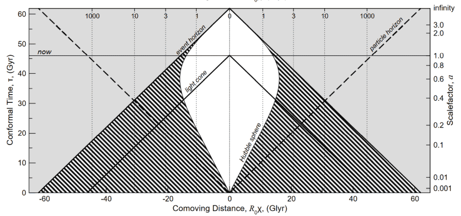

Forgive my ignorance, but wouldn't "gravitational time dilation" be a factor considering the universe billions of years ago was more dense then universe of today?
But, as for a direct observation, I would imagine a change in red shift over time would be a much better value. An object approaching the edge of the observable universe should have it's red shift increase towards infinity as its light intensity approaches zero. This effect should gradually become more extreme the closer and object gets to the edge of the observable universe. The best part of this type of observation would also be that we could use it to determine how much of the red shift value is due to universe expansion and could help refine the hobble value H0.
  • #33
No. I don't follow why you think it would.
yes
No, it would not.
since such an effect (approaching infinity) doesn't exist, that makes no sense.
You seem to have some sort of belief that there is something magical about the "edge" of the observable universe. There is not. The objects at the remotest observable point in the observable universe are receding from us at about 3c and their red shift (about 1100) is not approaching infinity except in the most trivial sense that 10 is bigger than 9

@phinds In order for a distance galaxy to be observed, a photon released from said galaxy has to enter a region of space that is not moving away from us >C due to the expansion of space. This is why we have an observable universe that can change in size depending on the rate of expansion. Considering Scientists believe the universe is expanding at an accelerated rate, out observable universe will continue to shrink.
like traveling through a black holes event horizon, there is nothing special about it for the the object. But, observing said object here on Earth there is a distinction.
  • #35
Actually, this is a myth. If an object is observable (i.e., on our past lightcone), the object will always be on our past lightcone, even in universes that have accelerating expansion. As time passes, some objects that are not our past lightcone move onto our past lightcone, but, once on, no object moves off our past lighcone, i.e., the amount of stuff in the observable universe increases with time.
