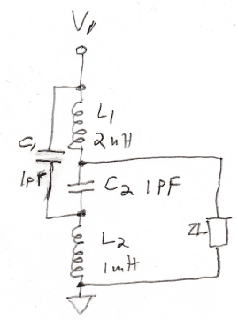

Hello everyone,
I need to solve a problem applying symmetry and superposition theorem but the problem is that the circuit is almost symetrical but has little differences in both sides (the source in the left side and the unknown impedance in the right side). I couldn't solve the problem using only Kirchoff's laws.
An example would be:
I know I can separate L1 in two inductances in series and L2 in two inductances in parallel but I don't know what to do with ZL.
The problem asks to determine the potential difference in ZL and the value of ZL when the potential in L2 is 0.
I would thank any help no matter how small
Thanks in advance

This is a trick question.
C1 in series with C2 is a centre tapped capacitor,
that with L1 makes a centre tapped resonator.
Think of L1+C1+C2 as a centre tapped transformer.
Under what condition will V(L2) = zero?

Yes. The centre-tapped transformer reference was a clue.
Looking for and recognising simple (lossless) resonators is part of the exercise. It resolves the whole of the problem without the massive error prone exercise in KL, followed by cancellation.
The resonator, with L2, is a symmetrical circuit. Apart from that there is only the source and a load.
The zero voltage across L2 is the biggest clue that could ever be given.
The source and load must be very simply related.
I await a solution via KL.
I will be interested to see if it confirms the answer.

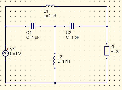

The circuit can be redrawn like this:

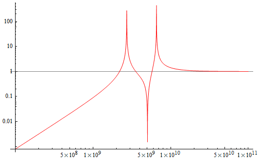

If ZL is not present all we have is a voltage divider with L2 as the bottom impedance, and the combination of L1, C1, and C2 as the top impedance. It's almost trivial to develop an expression for the output of the divider (the voltage across L2) when V1 (1 volt RMS) is the input to the divider. If we plot that expression (with ZL absent) vs. frequency we get something like this:
It looks like the voltage across L2 might be going to zero around 5 GHz. It will be more difficult to derive an expression for the L2 voltage when ZL is present. I leave it up to the OP to determine if in fact the L2 voltage goes all the way down to zero for some ZL.

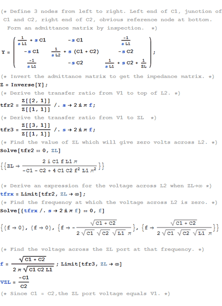

Here's my worksheet. Once I started with the Z parameters, I didn't check the results very carefully, so there could be a mistake in the algebra. Also I haven't included the rough sketches of the network under the various Z-parameter conditions (I1=0, I2=0, etc.), ask if you need to see those; I'll throw something together. Frankly, I have lost interest at this point. The original question about that specific load is easy, the general solution for any load is hard to simplify, and not the way real EEs would have to solve this.

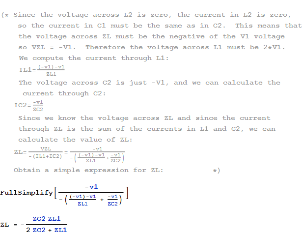

Since the voltage across L2 is zero, the current in L2 is also zero. Since the junction of C1 and C2 is at zero volts, the voltage across each capacitor individually must be the same. That's where symmetry comes in. Obviously the voltage across C1 is just V1, the supply voltage. So the voltage across C2 must be -V1 in order that the voltage at the junction be zero. So we reason like this:
Pick a frequency and get values for the two impedances, evaluate the expression and get the impedance of a capacitor.
