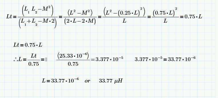

For part d) i have this (done on mathCAD) is this correct?
  • #97
Looks okay to me.
  • #98
Brilliant Thank you
