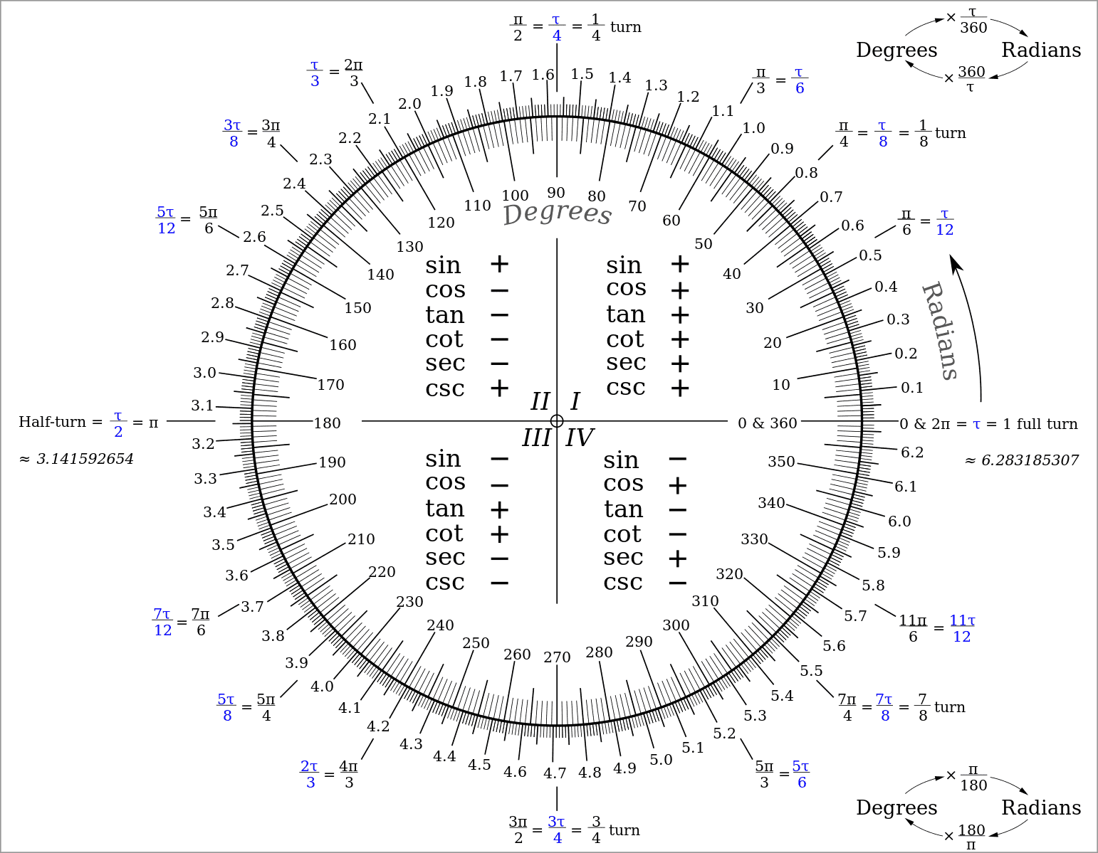

Here is an image of a unit circle with degrees marked off on the inside and radians on the outside:
Look at where $160^{\circ}$ is marked on the circle, what would you estimate the $x$ and $y$ coordinates of that point to be?

I found 160° on the circle but cannot estimate what the x and y coordinates of that point are, honestly. Can you answer this question? I can then use your steps to try the rest.
It would be easier to use your printed diagram and a ruler, but I can't locate that problem in section 6.2 of my copy of the book. I would begin by measuring the radius of the circle, from the origin, to the circle along one of the axes, we'll call this $r$. Next, measure the horizontal distance from the $y$-axis to the point on the circle at $160^{\circ}$, which we'll call $x$. And finally, measure the vertical distance from the point to the $x$-axis and call this $y$.
Then:
$$\sin\left(160^{\circ}\right)=\frac{y}{r}\approx\,?$$
$$\cos\left(160^{\circ}\right)=-\frac{x}{r}\approx\,?$$

I realized I could use the above image and measure the pixels, and I found:
r = 428
x = 404
y = 148
Using these measurements, I find:
$$\sin\left(160^{\circ}\right)\approx0.3458$$
$$\cos\left(160^{\circ}\right)\approx-0.9439$$
Using a calculator, we find:
$$\sin\left(160^{\circ}\right)\approx0.3420$$
$$\cos\left(160^{\circ}\right)\approx-0.9397$$

I am not getting this at all.
How did you conclude sin (160°) is approximately 0.3458 reading the unit circle provided? Write down the steps?

Using the image I posted, I found the radius of the circle to be 428 pixels, and I found the distance of the point on the circle at 160° to the $x$-axis to be 148 pixels. And so:
$$\sin\left(160^{\circ}\right)\approx\frac{148}{428}\approx0.3458$$

Explain this pixel stuff.
I understand this:
sin (a given degree) = d/r, where d = distance of the point on the circle at the given degree and r = radius of circle.
I am confused about the pixel reading. Good night. I will read your next reply tomorrow.

I loaded the image into MS-Paint, and then used the line drawing tool to measure the distances. It was simply a means for me to measure the distances without having a printed image that I could measure with a ruler.
