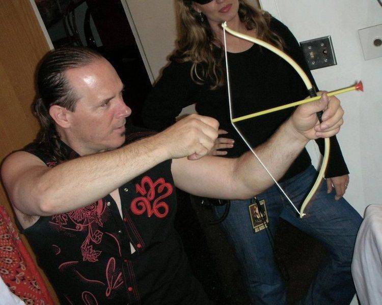

Lethal? Not so much...

And the arrow. The ones with a rubber cup on the business end are not as deadly as the ones all sharp and pointy.

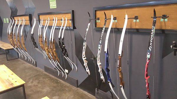

These are what you can find in typical archery centers inside malls (they are ones I tried and it's my first time). How deadly are these? In our estimation, this can hardly reach 1 inch beyond the flesh (of say cows). In warfare arrows.. how far they can reach inside the flesh?
Suffice to say, for safety reasons and because they don't expect random people at a mall to be very strong, the "draw weight" (Google that...) of those bows will be a small fraction of what a hunting or war bow draws...and the arrows are lighter, with duller points.
An arrow/bow that can pierce a steel plate would go all the way through an unarmored person.
Look at the numbers by these bows - that's the draw weight. It's the weight equivalent that your arm has to support at full draw (between 28 and 32 inches, depending on construction of the bow).
I can only barely make out the first two, which are in the 20s-30s pound range. Such poundages are given to archery first-timers, so that they can start learning the technique.
It's likely the ones further on the left are heavier. You wouldn't see much of a difference visually. It's just a matter of slightly thicker or broader limbs.
As you go up with draw weight, you need more and more muscle to use it, and also increasingly heavier arrows (for one, they're stiffer, so won't get damaged upon release).
IIRC, the legal requirement for bow hunting (deer) in USA is 45 pounds. Anything less is considered not powerful enough to cause incapacitating wounds. As a rule of thumb, if it can kill a deer, it can kill a human. For wartime use you'd likely want no less than 60.
English longbows recovered from the Mary Rose wreckage are estimated to have been between 100 and 180 pounds draw weight, but that's a bit on the extreme end of the scale.
Ask around what's the heaviest bow they've got, and give it a try to get a feel for the difference a few extra pounds can make.

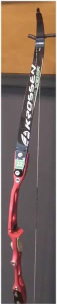

The one on the left most is written 22:
What is the legal maximum draw weight of bows sold in sporting good shops? Maybe for tactical bow&arrow used by say the Delta Force, it needs license? Because bows&arrows can be considered lethal or deadly weapon so there should be licenses for more draw weight, no?
By the way, what is the draw weight of the bow & arrow used by Katniss Everdeen? It's so deadly accurate.

Great post, except that I suspect those numbers are the hook/bow number, not the draw weight... :wink:
