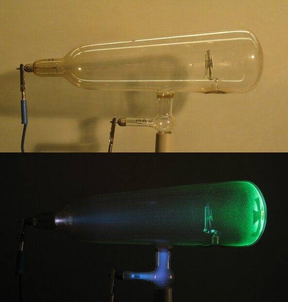

OK so here is a photo of a real one. Are the field lines curved down toward the anode?
"Down"? gravity is irrelevant, the electrons travel from a negative to a more positive potential. The Crookes tube was an accident waiting to happen. It was not designed by a specialist in electron optics. Where are you trying to go with this thread?
The cathode-rays = electrons, causing florescence of the glass bulb surrounding the cross, must be reaching the anode terminal via the contaminated internal surface of the tube. The entire bulb and cross outside the cathode neck becomes the "anode". The internal coating on the glass will not be visible.
We can see that the tube was only partially evacuated by the plasma forming in the narrow necks near the electrodes. We know that plasma from near the anode sprays the inside of the envelope with anode metal when the tube is first powered.
Maybe the manufacturer got best results by flaming the inside of the bulb before sealing. That could provide the network of surface carbon needed to conduct electrons to the anode terminal via the wall.
Plasma in the cathode neck would have ionised and stripped the surface there, making a better glass insulator. I expect a tube like that always works better after it has been “warmed up”, or they would have thrown it away.
Looking at the green glow on that tube face, it seems as if the lower part is brighter than the upper part. That could suggest (reasonably?) that the fields due to the anode and internal connection are causing the fields around the cross to 'bend' downwards. The drawing is clearly over-simplified.
The tube is much simpler than the sort of thing I was originally commenting on (see this link for a school demo model) but there must be a reason for using an anode in addition to the cross. I guess it still manages to produce a stronger accelerating field for the emitted electrons (about twice - due to half the distance). After passing the anode, the electrons are more in 'free fall', the field component between the anode and cross will be zero with a downwards tilt. Mutual repulsion of the electrons will continue to diverge the beam. This is a crude version of the arrangement shown in my link which uses a circular anode which, at the very least, gives some symmetry. So called electron optics is a very subtle technique and has advanced greatly over the years. Your version is groundbreaking in its way, of course.
