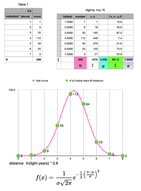

Kind of weird how the stars on that list fit a Bell curve almost exactly.
Perhaps I'll turn that into a homework problem, as to why that is.

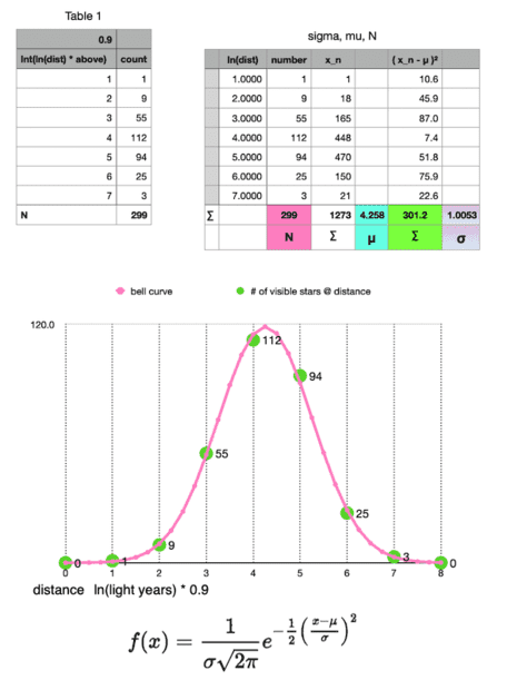

distribution of distances of visible stars from Earth. 2023-01-05 at 00.17.34.png
I wonder if this is how Planck got started developing his curve, sitting at home solving peculiar math problems.
I'm guessing the left side goes up like that because of increasing logarithmic volumes and the right side goes down because of the inverse square law.
Along with some distribution of star brightnesses thrown in to spice it up.

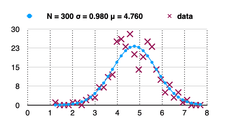

This is a very surprising discovery, in fact I tend to think it must be a coincidence, though one hesitates to assume a lovely Gaussian is a coincidence! Generally you get a Gaussian when you mix enough independent parameters that go into how bright something looks (central limit theorem), but it's not obvious that enough independent things are being mixed. It seems like it is basically three-- the stellar luminosity, distance, and dust absorption per LY along the way. Each of those have their own distribution, but only dust absorption per LY would be likely to be distributed like a Gaussian, and it should not really matter for the closer stars.
If you neglect dust absorption, then everything else is pretty much distributed like a power law-- the distribution of stars over luminosity, the distribution of volume over distance, and how luminosity converts to a naked eye threshold with distance, are all power laws for the main-sequence stars (and the red giants have their own rules, but still that's only two sets of objects, dwarfs and giants, not really a lot of mixing there). So one expects the distribution to be a power law, or perhaps a sum of two power laws to include the red giants, until dust absorption comes into play (using ln(d) as the variable just increases the power by 1, it's still a power law). So the most natural interpretation of your result is that you start out with something like a power law, then start cutting it off at larger distance, presumably due to dust absorption. But that certainly doesn't explain the symmetric Gaussian you obtain!
Still, the possibility that the perfect Gaussian is a coincidence is further supported by the extremely good fit that is achieved, when such small number statistics should not produce such a good fit. Given the expectation of statistical variations on the order of the square root of the numbers plotted, only the central three values are anywhere near statistically significant enough to fit a curve right through them. So if you really only have three points to fit a curve through, and a Gaussian has three parameters, you can always do it. You might be skeptical of that conclusion because it does not explain why that same Gaussian fits the points out on the wings, but remember those points represent 25, 9, 3, and 1 star, so the statistical variances on those numbers are pretty large-- meaning that you should really not expect any curve that fits the central points to also fit right through those! It is an "embarrassment of riches", so I think it has to be a coincidence, given those statistics, even though it is rather amazing that it fits so well to that Gaussian.

As far as the bell-like distribution, well, the shape needs to be generally "belly". At one end you need very bright stars to see them, and they are rare, and at the other end you need dim stars to be very close and they are rare too. (Trivia question: how many stars are visible to the naked eye and are dimmer than the sun?)
The x-axis is in magnitudes as opposed to something more reasonable like Janskies. So it's really not a normal distributiom - more like lognormal. Those show up when you have products of random numbers instead of sums, and that seems a lot more plausible.
Also, a normal distribution has 3 parameters and we only have 6 significant points. So I don't think this is surprising. More an "oh" than a "holy smokes!"

I believe the x axis is ln(distance), so the only place brightness comes into play is in the cutoff minimum apparent brightness that goes into the set of stars, which can be measured in any unit without consequence to the shape of the curve.
That's what I meant about the fact that there are really only 3 statistically well-quantified points, and the other 3 should have significant uncertainties so it's pretty coincidental they fit perfectly to any smooth curve, let alone a nice symmetric Gaussian. I suspect that a more complete distribution (say if it included the 10,000 brightest stars) would not be Gaussian, because the rise seems to be due to an ##f(L)## function that is less steep than ##L^{-3/2}## due to red giants, and the turnover is due to the fact that we live in a region where there has not been a lot of recent star formation, so that should not even make a symmetric curve, let alone Gaussian. So it's really a remarkable coincidence that the curve looks so perfect, given the statistics.

  • #32
I think it's just a happy coincidence.
Expanding the grouping to 34 points yields a much dirtier fit.
x-axis: 0.9 * ln( distance in light years )
y-axis: star count
Now if I can just figure out how to extract less than a billion data points from the Gaia database, I'll be able to make some more fancy graphs.
