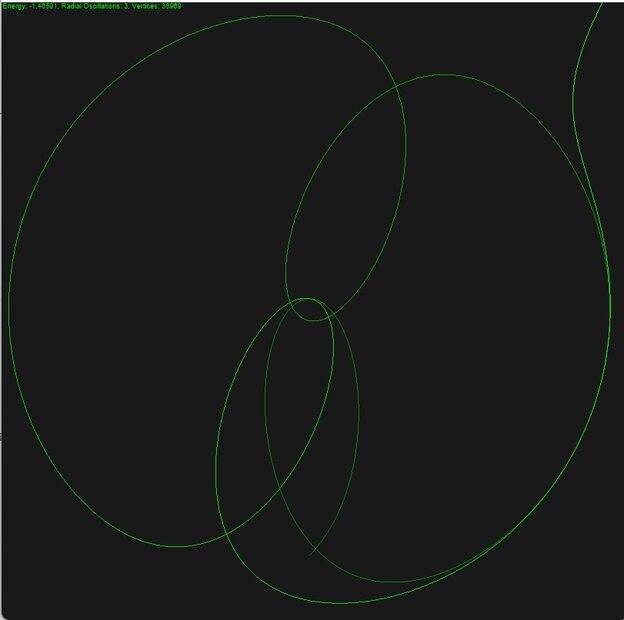

So, I had some slightly wrong conclusions from my simulation because there were some lingering inaccuracies. I improved the approximation algorithm so that now in the Newtonian case it will perform over a hundred orbits of an elliptical orbit with no visible change in its shape (the previous algorithm was causing orbits to become noticeably more circular over time). So I'm pretty confident it's doing the right thing now. The old algorithm was preventing some cases where the test object would make multiple passes before escaping. With the new algorithm, it can definitely take much longer to escape. So the conclusion I wrote earlier about it separating within about one orbit is just wrong.
Anyway, here's an example of a non-circular orbit that is close to criticality. It makes 3 passes of the closest point in its orbit before escaping (I can tune the parameters so it'll take a dozen passes or more, but it's much harder to see what's going on). As the orbit gets closer and closer to criticality, the lobes get "fatter", so it spends more and more of its time close to what is presumably an unstable circular orbit.
That is physically impossible with the model used in the paper. To me it sounds like you are still hitting some numerical instabilities (which are very likely to occur close to criticality).
Edit: Of course, this just goes to show just how unstable the unstable solution is.

There are definitely instabilities remaining. Each time iteration introduces a tiny error, so it's as if the orbit is being continuously perturbed by a small amount. But that should make it less likely to orbit multiple times before escape, not more. As was the case when the model was biased towards circular orbits in my first attempt. In that earlier attempt, it would very much either escape quickly or drop into a much more stable orbit. It had to, because after the first orbit it would be pulled away from the critical point by the bias in the model.
How are you reaching the conclusion that the non-circular orbits must separate so quickly? I don't think you've explained that.
By the way, in the current simulation, energy is conserved by construction and never changes throughout the run. Angular momentum is very slightly not conserved, shifting by something like a few parts per hundred million each orbit. The bias seems to be towards lower angular momentum, which would again tend to make orbits less likely to escape after multiple iterations.
It is a basic energy argument from the effective equation of motion for the radial coordinate. Energy conservation leads to

Very interesting. So, I was a bit unhappy with the precision of the previous model so I made another small tweak: varying the time step to be based on the gravitational potential, so that more time steps are taken when the test mass is close to the center (there was a lot of inaccuracy at the point of closest approach). After adjusting the time stepping, the energy and angular momentum are both now conserved to about one part per billion at all points in the orbit. This is maximum cumulative error, not the error at each step.
But now the model is back to sometimes making a number of orbits before proceeding out to infinity.
My guess at what is happening here is that the tiny numerical instabilities, as small as they are, are enough to sometimes kick an object which is in a bound orbit near the point of criticality out of that orbit and over the edge.
This loops back to an earlier question I had, whether non-circular orbits can be unstable, and I think this answers it. If the orbits were stable, these small deviations (one part per billion or less) would have no chance of causing the orbit to become unbound: either it would undergo less than one full radial oscillation, or an infinite number.
And I think this had to be the case. It is possible to incrementally tune the energy of a non-circular orbit so that it incrementally increases. At some point it would become unbound. And because the effective potential has a maximum, orbits near that point have to be unstable. From my empirical analyses, it looks like those unstable non-circular orbits always trace close to a circular orbit for a while. Presumably the outer parts of any unstable non-circular orbit always lies very close to an unstable circular orbit.

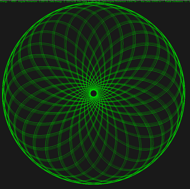

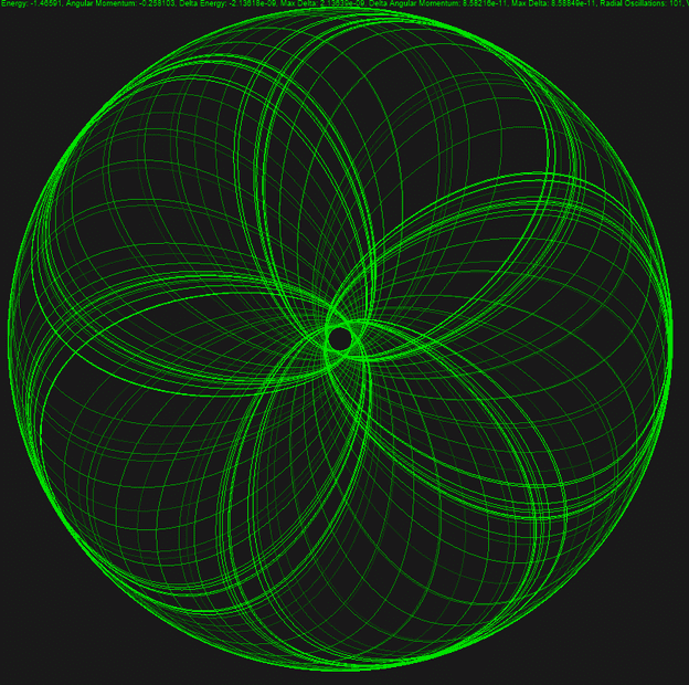

Edit: Further supporting the instability case, I found a case where the orbit separates during the second radial oscillation. Increasing the initial velocity very slightly caused it to separate after a whopping 42 radial oscillations. This supports the situation where the initial orbit was in a bound state in either situation, but was kicked over the potential barrier by numerical instability.
Oh, and another sign of instability in the non-circular orbits near criticality is that they don't appear to have periodic structures. If I move the orbit away from criticality, the resulting pattern is very regular. Attached is one example of an orbit that is 0.000002% below the critical point, which shows a beautiful structure that is highly periodic.
There's also a second image much closer to criticality, where you can see that much of the periodic structure is disrupted (basically, the angular deviation during a radial oscillation varies each orbit). This second orbit is about a billionth of a percent below the critical point.
I interpret this as stating that small deviations to a non-circular orbit near criticality will have a tendency to drop it into a noticeably-different non-circular orbit. So the orbits are not only unstable in the sense of only small deviations being required to make them unbound, but also in terms of entering other bound orbits.
