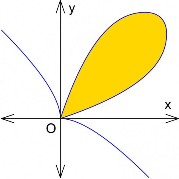

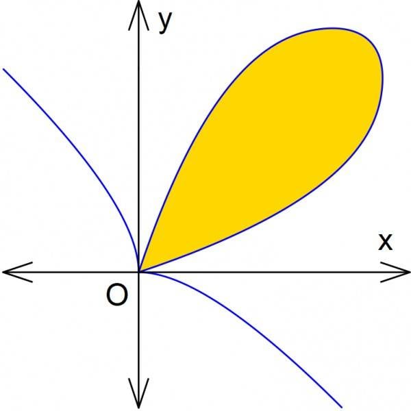

İt looks folium of Descartes I mean ##x^3+y^3=3axy##
This is the curve ##x^5+y^5=3x^2.y^2##

From given equation if ##x=rcos\theta ## and ##y=rsin\theta ## then ##r=\dfrac{3cos^2\theta.sin^2\theta} {cos^5\theta +sin^5\theta } ##

##f(x, y) =x^5+y^5-3x^2y^2=f(y,x)=0##
##x=rcos\theta## and ##y=rsin\theta ## ##r=\dfrac {3cos^2\theta. sin^2\theta } {cos^5\theta +sin^5\theta } ##
##E^*=\{(r, \theta) :0\le r\le
\dfrac {3cos^2\theta sin^2\theta } {cos^5\theta +sin^5\theta }, 0\le\theta \le\pi/4\} ##
##S(E) =2\iint\limits_{E^*} rdrd\theta=\int_0^{\pi/4}(\dfrac{3cos^2\theta. sin^2\theta }{cos^5\theta +sin^5\theta }) ^2d\theta
=\int_0^{\pi/4}\dfrac{9cos^4\theta. sin^4\theta}{(cos^5\theta +sin^5\theta) ^2}d\theta ##
Dividing numerator and denominator by ##cos^{10}\theta##
##=9.\int_0^{\pi/4}\dfrac{tan^4\theta. sec^2\theta }{(1+tan^5\theta) ^2}d\theta ##
##u=1+tan^5\theta##
##=\dfrac 95\int_1^2 \dfrac{du} {u^2}=0,9##

We could rotate the curve by ##-45°## so that it becomes a function, say ##v=v(u).## The result would then be
2\int_0^3 v\,du=2\int_0^{2,12132} v(u)\,du
but ##v(u)## is a nightmare:
v(u)=\sqrt{
-\dfrac{5\sqrt{2}u+3}{5\sqrt{2}u-3}+\dfrac{2}{5\sqrt{2}u-3}\sqrt{10u^2+12\sqrt{2}u}}

Not really a "different" solution, but here's a useful equivalent way to set up the general problem of finding the area ##A## of any 2D region ##R## bounded by the closed-contour ##\partial R## by using Green's theorem:$$\oint_{\partial R}\left(Pdx+Qdy\right)=\iint_{R}\left(\frac{\partial Q}{\partial x}-\frac{\partial P}{\partial y}\right)dxdy\tag{1}$$Set ##Q=x,P=0## or ##Q=0,P=y\tag{1}## to find:$$A\equiv\iint_{R}dx\,dy=\oint_{\partial R}x\,dy=-\oint_{\partial R}y\,dx=\frac{1}{2}\oint_{\partial R}\left(x\,dy-y\,dx\right)=\frac{1}{2}\intop_{0}^{\theta_{\text{max}}}\left[r\left(\theta\right)\right]^{2}d\theta\tag{2}$$where in the final form we've switched to polar coordinates using ##x=r\left(\theta\right)\cos\theta,y=r\left(\theta\right)\sin\theta##, and ##\theta_{\text{max}}## is chosen so that the integration range sweeps exactly once around the contour. For your specific problem eq.(2) becomes:$$A=\frac{1}{2}\intop_{0}^{\pi/2}\left[\frac{3\cos^{2}\theta\sin^{2}\theta}{\cos^{5}\theta+\sin^{5}\theta}\right]^{2}d\theta=\frac{9}{10}\tag{3}$$which is exactly your result.

I have deleted my scribblings since then. I used WA to picture the graph (as in post #4) and saw the symmetry at 45°. Then apply the rotation matrix to (x,y) and get (u,v). This gives a polynomial in (u,v). I guess I used WA again to resolve it for v. If we demand v>0 then we get half the area, but we gain a function v(u) instead of only a relation.
