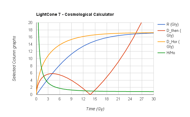

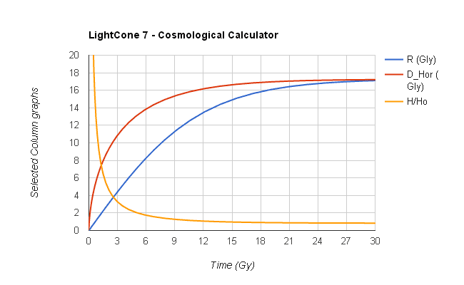

Since the speed of recession is approaching the speed of light the star would be red-shifting. The horizon of the Universe behave very much like a black hole event horizon, the star would appear frozen at the horizon and red shift out of existence.
This is not quite correct. The distance to the cosmological horizon D_Hor is larger than the Hubble radius R, where the recession rate equals c.
They only approach each other in the far future, when H becomes constant. Distant stars were always moving through the Hubble radius and we will see them farther and farther away, just red-shifting out of detectability, but never "frozen" at the horizon.
