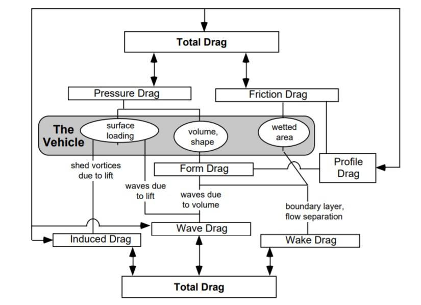

Perhaps turbulence or aerodynamic drag sound more erudite. They are kinds of friction although some folks reserve the term friction to a narrower scope. Your choice.
They aren't kinds of friction. Like friction, they are dissipative, but they are not "kinds" of friction, and they are no way abrasive to objects.

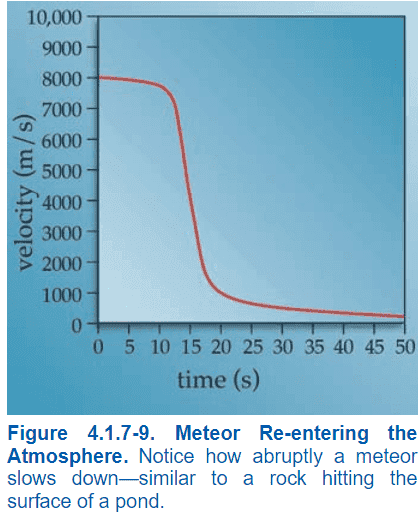

Drakkith said:
Here's a graph of a meteor's velocity vs time during re-entry:
Nice graph.
Nice write up.
Just a very rough calculation:
Average velocity 5000 m/s
duration 20 seconds
gross distance traveled = 100 kilometres
That's for a spherical-ish shape - no lift
A pointy object would travel much further, with less deceleration, but the nose would might melt off as the shock wave is 'attached' to the tip.
Blunt shaped space capsules and space shuttles have some lift to them, so would travel much further with less g's , as you pointed out. The shock wave from these objects with special curvatures is separated from the surface so the gas ( red or white hot due to the compression ) would have to radiate most of the heat absorbed by the surface rather than through conduction or convection.
It is interesting that all the engineering in the beginnings of the launching, and returns from space, was done with hand calculations, with a section of a sphere for the re-entry surface being chosen due to that being the most easiest if not just about impossible equations to manipulate with a slide rule and pencil. No computational fluid dynamics at that time.

boneh3ad said:
You've mischaracterized...
There are clearly different preferences with respect to terminology, and these lecture notes state the problem pretty well:
...basic drag nomenclature is frequently more confused than it needs to be, and sometimes the nomenclature gets in the way of technical discussions.
http://www.dept.aoe.vt.edu/~mason/Mason_f/CAtxtChap5.pdf
They include a very complex chart that isn't worth putting a thousand words into dissecting for the purpose of a narrow question in a forum thread:
246402
Likes hutchphd
  • #31
I do high speed aerodynamics for a living and that chart makes no sense to me at all.
