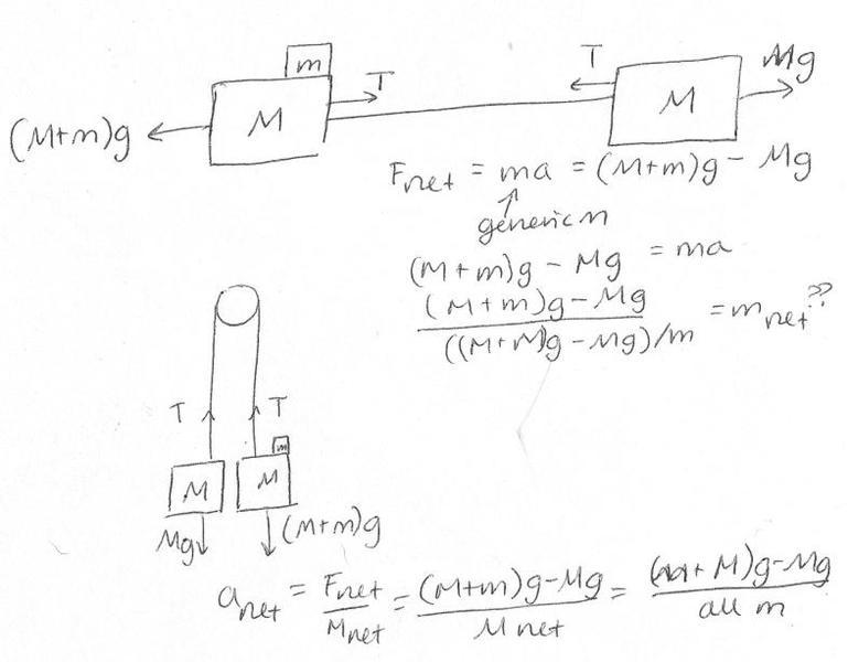

Symbolically solve the equation derived for the acceleration of the Atwood's machine in part 1, A-3 for the mass m in terms of M, g, and the acceleration, a. (No numbers.)
This question is part of a lab, so of course some other information is necessary. We were finding theoretical and experimental acceleration for an Atwood's machine when the masses on both sides were the same except for a few pennies balanced on one of the masses. After finding this value, we were using it to fine the theoretical and experimental weights of the pennies.
We were distinguishing m from M: m was the much smaller mass of the pennies, and M was the mass of the weights on both sides.

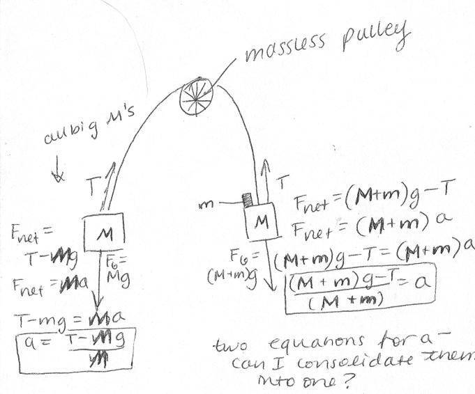

How I solved for acceleration can be found in attached image #1. The basic equation used is Newton's second law.
My weak attempt at solving for mass is in the second attached image. It all seems to cancel out and I'm getting really confused. Can anyone tell me where I made a mistake, or whether I'm just using really faulty, circular logic?
You only solved for the acceleration in terms of the tension. Finish the job. (You should be able to solve those two equations together to get both T and a in terms of the masses.)
Here it seems like you gave up on what you started earlier and tried a different approach. Nothing wrong with the basic idea, but you seemed to have gotten messed up with the 'net mass'.
Stick to those two equations you started with. Solve them together and you'll be fine.

Your algebra is getting a bit mixed up. In several cases, you've ended up with things like 'a + T'. That means you're adding an acceleration with a force, which is physically meaningless. (It means you made a mistake somewhere.)
It's easier than you think. Start with the two force equations:
(M + m)g - T = (M + m)a
T - Mg = Ma
How can you combine these two equations to eliminate T? (Don't be in a rush to isolate 'a' in each.)

Careful. That second equation should have M, not m. Redo it.
When you add and then simplify the equations, remember that you are solving for 'm', not 'a'.
T - Mg = Ma
(M + m)g - Mg = (M + m)a + Ma
Mg + mg - Mg = Ma + ma + Ma
mg = 2Ma + ma
mg - ma = 2Ma
m (g - a) = 2Ma
m = 2Ma / (g - a)Does that look right?

Perfect!
Oh, also, this would also make a = mg / (2M+m) with some rearrangement, right?
Right!
You got it.
