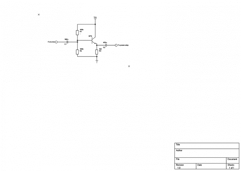

I have made an audio amplifier using an LM386 IC, but it does not amplify any sound from the microphone. Please help me to improve this using a Darlington pair or any other power transistor like the TIP147/142...

I have cascaded these two , means first i install the Common colletor because of high input impedence and then i apply its output from emitter to LM386 ... but theere is no sound which i applied on common collector base. which type of microphone should i use for this.. please guide me.
Well, the common collector stage you have shown is just a textbook drawing. What does your real circuit look like?

Your common-collector stage needs fixing! You'll almost certainly need a capacitor to couple the signal from the mic to the base, and this capacitor needs to go directly to the base (you are showing the mic wrongly connected directly to the power rail, Vcc).
you please draw the picture on peper and send me here? as it does not work till now.
Here is a schematic for a "common collector" stage.
