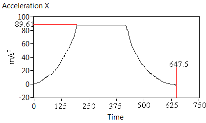

I'm actually working on a project, which record the acceleration of a golf club via an accelerometer.
And with the data of it i have manage to draw a graphic of a golf swing.
My question is : how can i get the average speed of the recorded data.
Indication, the time is in ms.

The final speed will be the integral (area under the acceleration / time graph). One form of 'average' speed would be half of the final speed. Another form of average could be the mean value of speed - which you could get by plotting the value of the integral from time t = 0 to time t, for all values of time - giving you a, 's' shaped curve - and calculating the mean value of this. I wonder what, exactly, you want to use this figure of average speed for. Are you sure it's what you need?

The graphed acceleration data that I see is only for one direction. If you are after average "speed" than you would need to integrate the x, y and z components separately and combine the resulting component velocities using the Pythagorean formula to compute speed.
The graphed acceleration data that I see appears to have a sharp cut-off value. It is unlikely that this reflects reality. It is more likely a limitation of the accelerometer.
Trapezoidal rule should be fine for the integrations of the component acceleration to yield component velocitys. No need to get fancy when the underlying measurements are suspect anyway.
Also, the acceleration reported for each data point probably amounts to a weighted average of the actual acceleration in some small time period. My intuition says that getting fancy with something like Simpson's rule would be, in some sense, averaging an average -- adding fuzz to fuzz.

I do integrate the curve I posted earlier, and then divide it by the duration time, i get a high number(15k ish), and even with the gravity constant i don't think i should get that much.

The graph you show has an acceleration peaking at 89 meters/sec2 with a duration of less than one second. That means that the result of the integration should be no more than 89 meters per second.
How many sample values are you integrating over? One per millisecond?
Did you multiply each measured acceleration value by its associated duration (e.g. .001 second) when doing the integration?
Why would you want to divide by duration? The result of the integration up until time t will give the instantaneous speed at time t. If you add up all of the computed speeds you should divide by the number of computed speeds to get the average.
More precisely you would be multiplying each computed speed by the width of the interval during which that is the estimated speed, adding up those products and dividing by the total duration. If you forgot to multiply by that .001 interval size a second time, that could be the source of your problem.
Even more precisely, you should be integrating vector-valued acceleration to get vector-valued velocity, taking the magnitude of the velocity to get scalar speed and averaging that.
Thanks again for so much help, your answer JBringgs444 about assiciate the duration with the acceleration value permited me to see the mistake i had in my program which is supposed to integrate the curve, now i get plausible speed.
