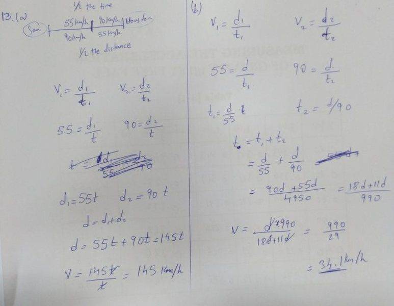

I'm very stuck at answering parts (c) and (d)
speed = Distance/Time
I haven't worked the problem myself, but I am not sure your solutions to parts a and b are correct. Does it make sense to have average velocities higher or lower than both velocities? Perhaps this is why you're struggling on c and d.
In both a) and b) you got confused between the half (time or distance) and the whole.
For d), what is the difference between speed and velocity?
