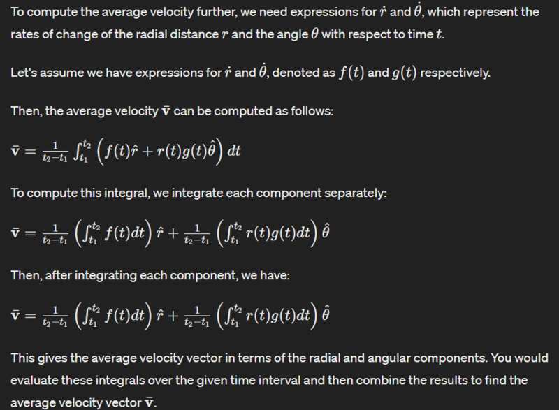

sorry for a late reply but, just one question is the following expression correct for average velocity in plane polar coordinate system?
The unit vectors are functions of time. You cannot take them outside the integral over time. Wasn't this already mentioned in several posts?
yeah i see it so can you provide the correct expression please
Correct expression for what?
The average velocity is usually defined as ratio of displacement and the time interval the dispalcement happened. ##\vec{V}_{av}=\frac{\Delta\vec{r}}{\Delta t}##. If you want to express the displacement in polar coordinates you have to define what do you mean by this. What is the origin of the polar coordinate system, for example.
Just take any vector that does not pass through the origin of your carthesian system. How do you express this vector in polar coordinates?
