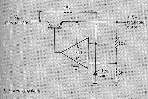

ranger said:[Circuit I. - +15V regulator]
So far I see the following problem with it - the missing base resistor shows an improperly biased BJT.
ranger said:Berkeman, does this circuit have a problem with varying VE due to varying VB as the output of the op-amp varies depending on the voltage differential?
berkeman said:Why can't the opamp supply the needed base current?
ranger said:I don't understand this. Why not have a resistor to bias the BJT? The BJT has a relatively low input impedance. Shouldn't we want to avoid large output currents to prevent excessive power dissipation on the output stage of the op-amp![]()
AlephZero said:Powering the op-amp from its own stabilised output won't work. To bias the transistor, the op-amp output would have to be higher than the supply voltage, and that can't happen.
Powering the opamp from the unstabilized 20 to 30V supply should be OK.
Also, for better regulation of the output voltage I would supply the zener through a resistor from the stabilized 15V supply, not from the unstabilized supply.

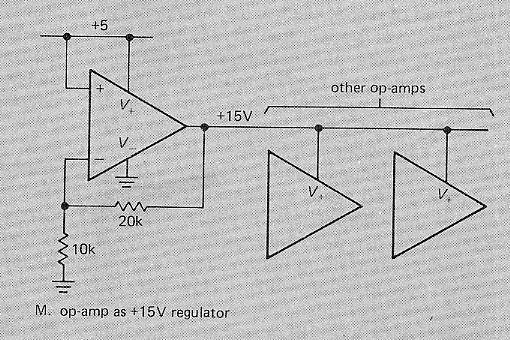

antonantal said:We can't have 15V at the output of the first opamp if it is powered from +5V.
berkeman said:AlephZero's comment about how to supply the zener is also a good idea.

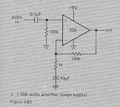

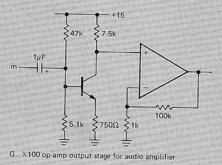

I don't have a scanner right now. Could you post circuit B (x100 op-amp output stage for audio amp) and circuit G (x100 audio amp. (single supply)) so we can get some thoughts on it? You should of course post yours first.
Good point about the cap, but they are probably assuming a pretty small signal (no more than 15V/100 one would hope), centered around ground as the audio input.antonantal said:For the first circuit, I don't know what is the range of the input voltage but if it can reach a higher value than the potential on the base of the BJT, that electrolytic capacitor is not a good idea.
antonantal said:In the second circuit, there is no dc path to the ground for the inverting input.
ranger said:Circuit G:
It seems a coupling capacitor is missing from the output of the bjt amplifier to the input of op-amp. There should also be resistor to ground to cater for the bias current on the non-inverting input. Also the resistor will set the f3dB frequency; I guess we don't want to amplify all frequencies.
Shouldn't we also want to add a cap in series with the 1K to have unity gain at DC? We'd of course choose are to have the appropriate f3dB frequency.

ranger said:Yes, I meant the last problem with circuit G.
Well to minimize such offset voltage, one could use a trimming network or simply use an op-amp with very small VOS or a FET amplifier which has little input current. Another way I see to eliminate the input-offset voltage due to offset current is to make the the resistances of both the inverting and non-inverting input equal. In this way, both inputs will have negligible offset voltage due to offset current becuase they see the same equivalent resistance.
According to the datasheet for the 741, we should expect a typical offset voltage of about 1mV. I guess this also applies to a properly trimmed op-amp?
dlgoff said:Well I didn't look at the specs for the op-amp on the last circuit, but it looks like the non-inverting input needs to be biased up a bit. Wouldn't the output be clipped on the low side?

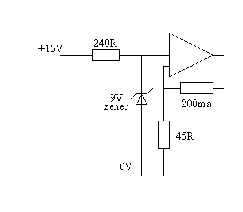

berkeman said:Okay, how about a couple last opamp circuits, and then we can switch gears. Here are two more from H&H Chapter 3 on opamps. I especially like the 2nd one [F], which was published in another textbook as an example of a "good" circuit idea...

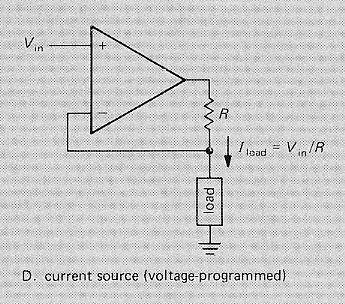

[D] Voltage-controlled current source

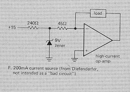

[F] 200mA "current source"

[D] I think it has something to do with R.
[F] Quick question about F. That "zener" thing in the middle with 9v next to it, does that mean there's a 9v voltage drop across it?
Sorry if I'm wrong, I'm still an undergrad with almost no real life experience.
NoTime said:Yes a zener is supposed to show a constant voltage.
It was intended as a 9v reference. Note that there is a maximum current that can flow thru the 240 ohm resistor before the voltage will drop below 9v.
In [D] there is something you can do with R that would fix the major issue.
What do you think it is?
Not if a 200ma load current is desired.berkeman said:Maybe altering the 240 Ohm resistor value might make this circuit work
berkeman said:Good job folks on circuit [D].
It looks like they were trying to make an opamp circuit that would take a current 9V/45 Ohms and pass that current through the load. Maybe altering the 240 Ohm resistor value might make this circuit work, but it's dumb to brute force push extra current through the 9V Zener (and have to use a bigger, more expensive Zener part), when the opamp is supposed to be the amplifying device. Do you see a way to use the topology of circuit [D] instead (after being fixed with the swap that we talked about)?
Yes, the negative feedback voltage will approximate the reference voltage.ranger said:we would apply the reference voltage of 9V to the non-inverting input.
we would have the zener voltage at the inverting input.
The choice of zener bias resistor (the 240 ohm) will affect the final load current.ranger said:We'd of course need to bias the zener properly by choosing an appropriate resistor.

Your second answer makes me wonder just where did you put the 240 ohm resistor and zener?
Ouch! No!ranger said:The 240ohm is connected to the 15V power supply, the zener to ground (anode:ground; cathode:inverting input), and the inverting input is hooked up to the zener to get the reference voltage. No?
ranger said:we would apply the reference voltage of 9V to the NON-inverting input.
NoTime said:Ouch! No!
Where did you lose this statement?Take another look at the revised circuit [D]

So what is your final solution?ranger said:So I guess we can wrap up circuits D and F?
NoTime said:So what is your final solution?
Say where the 45 ohm resistor gets connected also.
You could also try to figure out what the op-amp parameter is that you left out of the list before.![]()
After your statement that this solution involves connecting the 240 ohm and zener to the inverting (-) input of the op amp. I have to say your solution is wrong and it's back to the drawing board for you.ranger said:Well my final solution is this:
https://www.physicsforums.com/showpost.php?p=1392945&postcount=83
ranger said:I'm still unsure as to whether the answers to the questions you asked in post #84 are in my post #85 and #87.
I believe the final op-amp property I left out was slew rate.
NoTime said:After your statement that this solution involves connecting the 240 ohm and zener to the inverting (-) input of the op amp. I have to say your solution is wrong and it's back to the drawing board for you.
ranger said:I indicated that it was a typo, and the linked post (#83) states that I have the zener to the non-inverting input. You're beginning to confuse me![]()
berkeman said:** The second issue raised by NoTime is a very important one, and I'll add an extra twist to it. Look at a datasheet for Zener diodes, like this one:
http://www.vishay.com/docs/85763/bzx84v.pdf
What current is the Zener voltage measured at for this small-signal Zener family? What should the resistor in our circuit be, if we were using this Zener series? What would be the effect of chosing a smaller or larger resistor than this?
And for my extra-credit Quiz Question -- how does the temperature coefficient of Zener diodes vary with Vz? What value of Zener diode generally has the lowest temperature coefficient?
