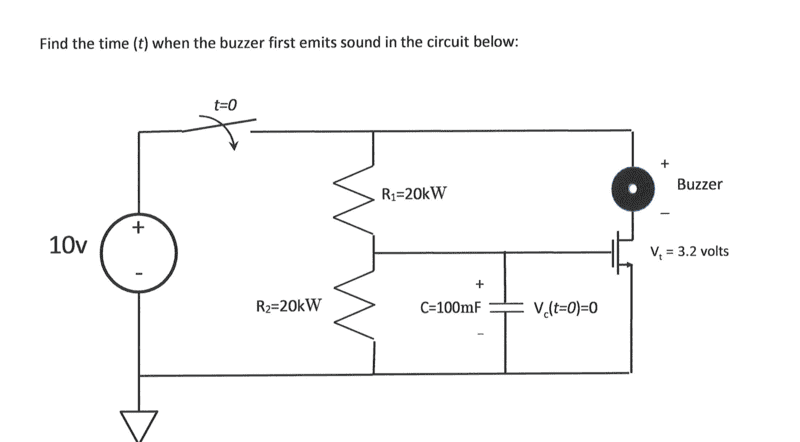

Find the time when the the buzzer first emits in the circuit below.
Noton theorem;
I don’t understand what does the v_t mean?
Vt is the threshold voltage of the MOSFET. When the gate to source voltage (same as the capacitor voltage) is greater than Vt, the transistor will conduct current from the drain to the source. If it's less than Vt the transistor is off.

Yes, I guess there is a type
Got it! So until the capacitor is charged to Vt, the transistor is off, which means I just analyze the circuit in which R1 and (R2//C) are in series. Now I guess I know how to solve it. Thanks much!
Likes DaveE
ZoeDale said:
.... which means I just analyze the circuit in which R1 and (R2//C) are in series.
Another view of the problem.
( R1 // R2 ) = Rt, the Thevenin resistance at Vt.
Rt is in series with C1.
Likes ZoeDale
Yes, the easy way, LOL.
It also requires that you find the equivalent (Thevenin) voltage source. 5V in this case.
Most simple transient problems can be solved with just knowing the initial state, the final state, and the time constant. But they don't really teach that most places.
Likes ZoeDale
Oh!!! So the time constant is decided by the equal circuit of Rt in series with C? So time constant \tao = Rt* C = 10k * 100m = 1000 ???!!! I need to go back to learn how I can derive that "( R1 // R2 ) = Rt, the Thevenin resistance at Vt." Thanks, Baluncore and Dave!

hi Baluncore, I didn’t get it how to derive the equivalent circuit of (R1//R2) in series with C, can you please tell me more about it? Or if it is convenient, can you show me the equivalent circuit? Thanks much!
You'll want to search for "Thevenin's Theorem" and "Thevenin and Norton source transformation" to learn more about these analysis techniques. This is the easy way to solve simple networks, IMO.
I think some offline study is your next best step. We can't really teach this with short comments. However, it's not difficult once you are familiar with KVL/KCL analysis.
