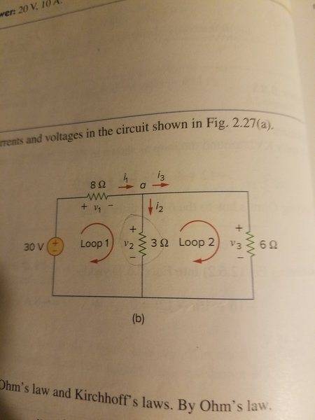

Hi, I attached a pdf file with the problem. My question is, for the lower right loop, why is the equation that they have valid? I worked the problem, but the equation that I got for that loop is...
voltage of 180 ohm + voltage of 30 ohm + voltage of 12 ohm + voltage of 18 ohm =0. so the voltage for the 180ohm, is -180V, but they have a positive 180V. How did they got that?

I just noted something. Does the direction of the current affects the signs (+ or -)? For example, if i have a KVL with a loop going clockwise, and when it reaches a resistor, that has a current going in the opposite direction (to the left), does that matter? If a kvl with a loop going clockwise hits the + sign of a resistor, will it always have a + sign regardless of the direction of the current on that resistor?
Yes the direction of the current affects the sign. Typically you assume a direction and if you're wrong you'll get a negative answer. It's as simple as that.
but if a keep the negative answer, I get a different result?
No, the negative answer just means the current goes in the opposite direction from what you initially assumed. Remember current is a vector quantity with a magnitude and a direction.

look at this picture from my book. In this example, what you said is correct, the assumed direction of current affects the sign. But on the other picture that i posted, they are not doing this. I think they are using a counterclockwise loop for the lower left loop in the other picture, but that should not matter. I used a clockwise direction and i got a negative answer, they used a counterclockwise direction, and they got a positive.
I agree with your explanation of the negative current in OP's answer, but current is NOT a vector.
