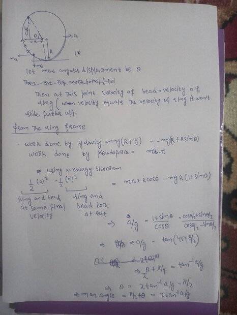

A bead is kept at the bottom of a vertical frictionless ring , if the ring is given an acceleration a horizontally, what is the maximum angular displacement of the particle?
The problem is easily solved from the frame of reference of the moving ring, I am however Intrested in a solution without use of pseudo force.

I have attached the solution w.r.t a non inertial frame you may take a look

Basically the problem involves using workenergy theorem, a non inertial frame eats away work done by normal reaction. since the bead motion in a non inertial frame is always perpendicular to the the Normal reaction . Same , however,doesn't hold when you allow the ring to move and thus a labouries variable normal reaction force awakens . You can see my solution attached as an image in the original question .thanks for the response though

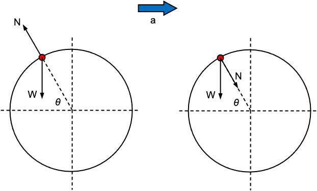

Thank you for posting your solution. I took a look and it does not make sense because the bead cannot be above the horizontal diameter of the ring without violating Newton's second law. Here is why.
I assume that the contact between the bead and the ring is without friction. There are two forces acting on the bead, gravity in a direction straight down and the normal force. The normal force is radial and can be directed either towards the center or away from it. Below are free body diagrams in the inertial frame showing the two possibilities. The acceleration is also shown directed horizontally to the left.
Look at the diagram on the left. The vector sum of the normal force and the weight, which is the net force, cannot possibly be in the horizontal direction.
Look at the diagram on the right. The The vector sum of the normal force and the weight, which is the net force, cannot possibly a zero vertical component which is required if the bead is to accelerate horizontally.
Ist of all thank you so much for taking time to think over it, but you are upon error here .bead will have attained some velocity before the horizontal diameter and then it will deccelerate because of the forces which you have already shown.
And even for the sake of argument it was to stop somewhere below the horizontal diameter (which it can if acceleration is small). The work energy theorem still applies.
Sure. The work theorem always applies. Which force does the necessary work on the bead to lift it above the horizontal diameter? In your solution you invoke the pseudo-force, but that points in the horizontal direction. It can provide a component tangent to the ring to lift the bead against the weight but only up to the horizontal diameter and it needs to be infinite to reach that point.

Thanks for that answer , I am interested in solving from ist principles ,I think I do have a solution already but why can't it be done from the ground frame is my real question here.
Work done by gravity bis same in both the frames just work done by normal reaction is bothering me.

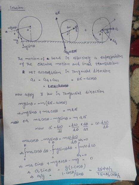

I finally got what I wanted, thank you all who showed interest
