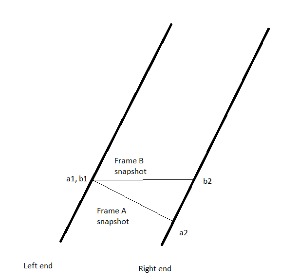

A meter stick is not a line segment the exists only as a snapshot in time. It has extent in time and is more like a parallelogram extending indefinitely into the past and into the future. When you measure its length, you are taking a snapshot at an instant in time according to some chosen frame.
When you measure the length of the stick in frame A, you are measuring from event a1 to event a2 such that a1 and a2 are simultaneous according to frame A.
When you measure the length of the stick in frame B, you are measuring from event b1 to event b2 such that b1 and b2 are simultaneous according to frame B.
Likes cianfa72, student34 and Ibix
So, @student34, the diagram in @jbriggs444's post is a spacetime diagram. The x position of something is shown horizontally and the t position vertically. In this frame, then, the length of the rod is the Minkowski interval along the horizontal line. In a different frame with a different x-axis (call this x') which slopes down the page, though, the length of the rod is the Minkowski interval along the sloped line. It isn't the same as the length measured by the other frame, but there's no superposition going on here. The two frames are just measuring along different 1d cross sections of the 2d rod.

Let's say that the back particle, Alice, Bob, and the zero end of both their rulers pass at one time (you called this 5pm). To measure the distance between the particles, both Bob and Alice make note of where the front particle is at the same time as the back particle passes them. But they do not have the same idea of what "at the same time" means, so both will say that they measured the front particle's position at time zero, but that the other did not. Thus the other includes some timelike separation in their length measure.
This is what is illustrated in jbriggs444's diagram on the previous page shows - both frames use the same event to measure the location of one end, but use different events for the other end.
