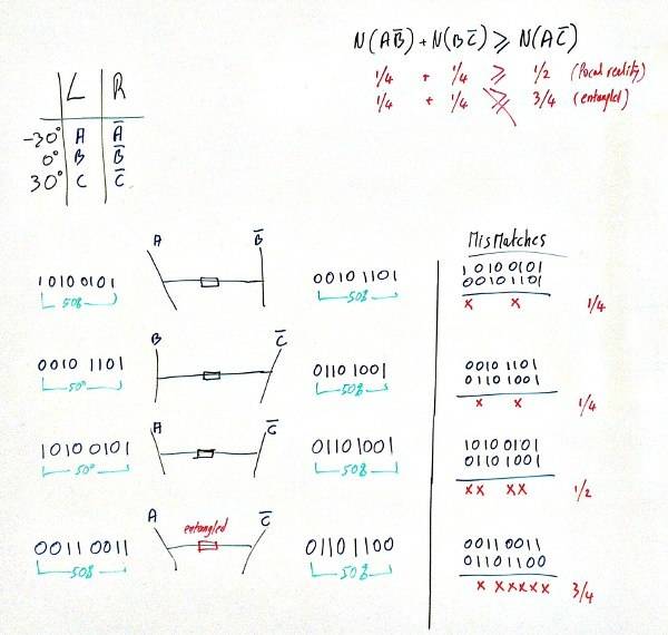

Even though it is geared towards the laymen, I'm having trouble applying the particle spin example to particle polarisation. I would very much appreciate if anyone could check the following reasoning for me:
Assuming the polarisation filters can be set to 3 angles: -30 degrees, 0 degrees, 30 degrees, I have the following states:
A : polarisation of photon after passing a -30 degree filter in the left detector
!A : polarisation of photon after passing a -30 degree filter in the right detector
B : polarisation of photon after passing a 0 degree filter in the left detector
!B : polarisation of photon after passing a 0 degree filter in the right detector
C : polarisation of photon after passing a 30 degree filter in the left detector
!C : polarisation of photon after passing a 30 degree filter in the right detector
I attach a little sketch here that describes the situation.
Bell's Inequality states: N(A !B) + N(B !C) >= N(A !C)
Problem I have is that the inequality for polarisation seems to fit for MISMATCHES, i.e for the photons that are NOT matching:
For local reality:
delta 30 degree mismatch + delta 30 degree mismatch >= 2 times delta 30 degree mismatch, or 1/4 + 1/4 >= 1/2
And for entangled photons:
delta 30 degree mismatch + delta 30 degree mismatch >= delta 60 degree mismatch, or 1/4 + 1/4 >= 3/4, which violates Bell's inequality (as it should).
Is this reasoning correct? And if so, why do I need to consider mismatches instead of matches?

This reasoning is correct.
Photons can be entangled in four different ways:
1. the same polarization when measured at right angles (0,90,180,-90) and the same polarization at diagonal angles (45, -45, 135, -135)
2. the same polarization when measured at right angles (0,90,180,-90) but opposite polarization at diagonal angles (45, -45, 135, -135)
3. opposite polarization when measured at right angles (0,90,180,-90) but the same polarization at diagonal angles (45, -45, 135, -135)
4. opposite polarization when measured at right angles (0,90,180,-90) and opposite polarization at diagonal angles (45, -45, 135, -135)
In your example it is assumed that we use polarization entangled photons of the first type.

Thanks Zonde, sorry to bring this back to basics (as the current discussion is no doubt more meaningful), but can you please explain how you connect my situation (0, 30, -30) to your first entanglement situation?
The number of matches and mismatches are related N=mismatches + matches.
The correlation which is in [-1,1] is defined as
( matches - mismatches)/( matches+mismatches) = ( matches - mismatches)/N
Look at formula (10) in this paper: http://arxiv.org/abs/quant-ph/0205171
##P_{VV}(\alpha,\beta)=\frac{1}{2}cos^2(\beta-\alpha)##
This formula describes correlation for my first entanglement type. You can plug in the angles from your example and get the numbers you where using.
Likes dbertels
