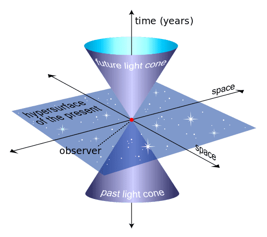

  • #56
DrChinese said:
If you want a visual, there is one class that most closely matches experiment. Most people reject these because causality is not respected. These are the time symmetric group of interpretations. In these, you have the following 2 key elements:
a) Both the past and the future are elements of the experimental context. So Alice's setting and Bob's setting are both part of the equation when particle pairs are created, even though they are set in the future.
b) Otherwise, locality (c) is always respected. Despite the "non-local" appearance of entangled pairs (which I don't dispute in any way): in these interpretations, everything is cleanly connected by local action.
One of the advantages of this visual is that it naturally explains entanglement which occurs after detection. Sophisticated experiments allows after-the-fact entanglement (hard to believe but true - you can entangle particles that no longer exist). Such is not natural in many other mechanistic explanations.
I totally need a picture. The above (I hadn't understood this post at all the firsttime I read it) is exactly what I mean I think. What I am amazed and confused by. Strange how the sentence "Both the past and the future are elements of the same experiment" Gives me a connotation rich image I can sort of hold onto to represent the meaning the amazing math has uncovered? I just hope it's sort of correct...
So now I would love to have just a couple of more pieces squared away.
Is there any sense in which entanglement is significant feature of space time evolution as we experience it? Or is it an utterly fleeting and rare exception? Or do we not know?
Does the bizarre non-causal a-temporal sounding statement a) above turn out to be utterly innocuous because the "experiment" always provides random results - leading to a conclusion like "well the future is already set, but the result is random". In which case what's the difference between random and uncertain? I'd guess it's about 1 big beer.
But then random seems unsatisfactory, if entanglement is a phenomenon that is involved in our evolution? this feels almost completely fuzzy, but I get this icicle in brain that's asking "where does all the structure come from"
  • #57
