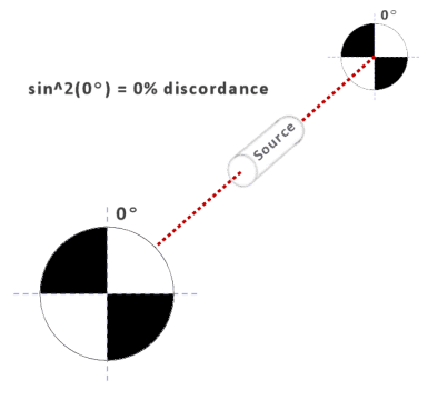

DrC’s example is superb, however if you want something even more related to polarizers and probabilities, Nick Herbert has an example known as one of the simplest proofs of Bell's Inequality (i.e. in serious competition with DrC ;). This example was also used by John Bell himself, giving lectures.
In the setup we have one source of entangled pair of photons and two polarizers that we can position independently at different angles. The entangled source is of that kind that if both polarizers are set to 0º we will get perfect agreement, i.e. if one photon gets thru the other photon gets thru and if one is stopped the other is also stopped, i.e. 100% match and 0% discordance.
To start, we set first polarizer at +30º and the second polarizer at . If we calculate the discordance (i.e. the number of measurements where we get a mismatching outcome thru/stop or stop/thru), we get:
sin^2(30º) = 25%
(according to QM theory & experiments)
Next, we set first polarizer to and the second polarizer to -30º, and the discordance we will naturally be 25% this time also.

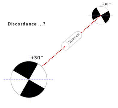

Now it’s time for John Bell’s brilliant logic:
– What will the discordance be if we set the polarizers to +30º and -30º...?
If we assume a local reality – nothing we do to one polarizer can possible affect the outcome of the other polarizer – we can formulate this Bell Inequality:
N(+30°, -30°) ≤ N(+30°, 0°) + N(0°, -30°)
(the symbol N represents the number of discordance)
Of course we can make this Bell Inequality even simpler, and say:
50% = 25% + 25%
25 + 25 = 50
1 + 1 = 2
(i.e. all the way down to the “kindergarten version” ;)
This is the obvious local realistic assumption – one banana plus one banana makes two bananas.
Now comes the shock (that makes some people go bananas) – this local realistic assumption is not compatible with neither QM theory predictions nor all performed experiment this far, which is:
sin^2(60º) = 75%
1 + 1 = 3 !
:bugeye: <-- he got one banana too many

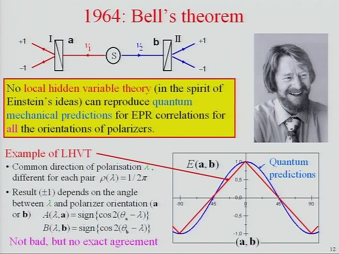

Correct, and this is exactly what Bell proved. We can try to construct all sort of fancy LHV with all the mathematical tricks you can think of, but we are not allow to account for the state of the other polarizer, or the outcome of the other photon. The best LHV we can generate is the red triangle wave in the diagram below:
[Credit: Alain Aspect]
And QM theory/experiments always produce the blue sinusoidal curve = an impossible nut to crack for the local realist’s...

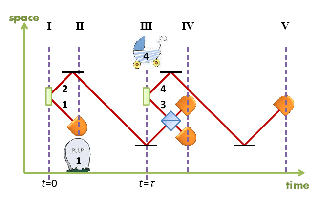

Nice papers DrC, of course I got hooked on the graphics in the last. :smile:
[PLAIN said:
http://arxiv.org/abs/1209.4191]
[/PLAIN]
FIG. 1. (color online). Time line diagram.
(I) birth of photons 1 and 2.
(II) detection of photon 1.
(III) birth of photons 3 and 4.
(IV) Bell projection of photons 2 and 3.
(V) detection of photon 4.
The delayed photon of the first pair and the non-delayed photon of the second pair are projected onto a Bell state by combining them at the projecting polarizing beam-splitter (PBS)
[my bolding]
I googled “projecting polarizing beam-splitter” and got 2(!) results. One to PF (your thread) and the other to the paper...
What the **** is it?? :bugeye:
It’s right there the “Entangled Love Affair” takes place, right? What’s going on? Just because you run two photons thru a PBS this ‘magic’ happens...?? How does one do the timing to get them exactly “in phase”...?? I don’t get it...?? :rolleyes:
Weird...
