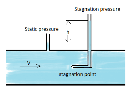

Here is the setup:
Apply Bernoulli Principle to the top (free surface) of the two pitot tubes (1 for static and 2 for dynamic with the points colored in red): $$\frac{p_1}{\rho_w g}=h+\frac{p_2}{\rho_w g}$$
The difference in air pressure would give the following:$$p_1=p_2+h\rho_{air} g$$
Solving for h would give: $$\frac{p_2+h\rho_{air}g}{\rho_w g}=h+\frac{p_2}{\rho_w g}$$ $$\frac{p_2}{\rho_w g}+h\frac{\rho_{air}}{\rho_w}=h+\frac{p_2}{\rho_w g}$$ $$\frac{\rho_{air}}{\rho_w}=1$$
Which is clearly false. Does anyone know what the error here is?

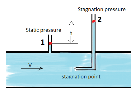

I clarified the location of the points by coloring them in red.
I'm assuming the two free surfaces are still and the system has reached a steady state.

##h## is referring to the difference in height between the two real columns of water in the pitot tube. ##p_1## and ##p_2## are the pressures at the free surface of these tubes. I'm equating the head between these two points.

Your equations don't appear to be related to Bernoulli from what I can tell. They are just adding hydrostatic pressures. If you want to incorporate Bernoulli, you would have a velocity in there. Either way, make sure you include all heights or you can rapidly lose track of things and get confused.
Let's call ##p_1## the pressure at the port for tube 1, ##p_2## the pressure at the port for the Pitot tube 2, ##h## the difference in height between the two water columns, ##h_1## is the height of the water in column 1, ##h_2## is the height of the water in column 2 from the top of the pipe, and ##R## the pipe radius (i.e. the height difference between the entrance to port 1 and port 2.
Then,
[tex]p_1=\rho_wgh_1+p_{atm},[/tex]
[tex]p_2=\rho_w g R + \rho_wgh_2+p_{atm},[/tex]
and
[tex]p_2 - p_1 = \rho_w g (h_2 + R - h_1) = \rho_w g (R+h).[/tex]
From Bernoulli's equation, we also know (since ##v=0## at the tip of the Pitot)
[tex]p_1 + \dfrac{1}{2}\rho_w v^2 + \rho_w g R= p_2,[/tex]
or
[tex]p_2 - p_1 = \dfrac{1}{2}\rho_w v^2 + \rho_w g R.[/tex]
Therefore,
[tex]\rho_w g h = \dfrac{1}{2}\rho_w v^2,[/tex]
or
[tex]v = \sqrt{2 g h}.[/tex]
Where does :
Come from??
hutchphd said:
Where does :
Come from??
That part I do think I get: over small distances the density of the air can be considered constant, so the atmospheric pressures at the two points do have that relationship.

Agreed, the pito/static probes are totally irrelevant to what the OP is doing. The problem can be simplified to show two vertical tubes, closed at the bottom, with different amounts (heights) of water in them.
I am woefully ignorant here but the pitot tube is measuring some kind of "dynamic" pressure from the flow ...my apologies if my terminology is wrong. Clearly the preceding equation and this one refer to different pressures somehow.edit: I just looked at the picture closely. The flow is in the water! Are these really pitot tubes? I defer to those with actualknowledge!
Certainly, and they differ due to the velocity (part of dynamic pressure) and height difference.
The pito tube measures total pressure, the static tube static pressure and the difference is velocity/dynamic pressure. But the OP isn't doing any work on that relationship.
The OP is examining the water columns themselves, not the flow situation.

This first equation of yours is already incorrect. It applies only to a system that is at static equilibrium, and this system is not at static equilibrium. The correct relationship, neglecting the tiny pressure difference due to the different elevations in the air is $$p_1=p_2$$
If H is the elevation of point 1 above the centerline of the tube and ##p'_1## is the pressure at the centerline, then $$p'_1=p_1+\rho gH$$ Then the stagnation pressure at the inlet to the pitot tube is $$p_s=p'_1+\frac{1}{2}\rho v^2=p_1+\rho gH+\frac{1}{2}\rho v^2$$where v is the horizontal flow velocity at point 1'. The pressure ##p'_2## at the end of the horizontal section of the pitot tube directly below point 2 is also equal to the stagnation pressure: $$p'_2=p_s=p_1+\rho gH+\frac{1}{2}\rho v^2$$Starting from point 2, the pressure ##p'_2## is also given by: $$p'_2=p_2+\rho g (h+H)$$ So, combining these last two equations yields: $$p_1+\rho gH+\frac{1}{2}\rho v^2=p_2+\rho g (h+H)$$But, since ##p_1=p_2##, as @boneh3ad indicates, this reduces to $$\frac{1}{2}\rho v^2=\rho g h$$
