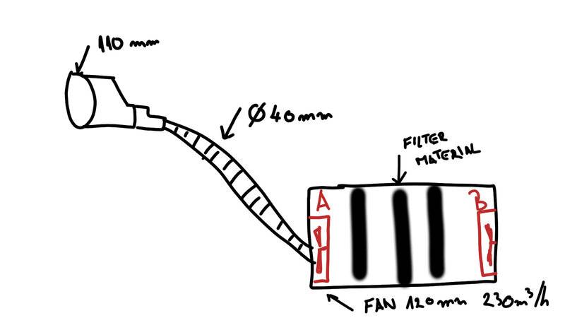

I'm building a fume extractor for my workbench. I would like to hear your thoughts on the best placement for a fan so I get the maximal suction/airflow.
I made a sketch with the general dimensions. The fan could be either in the A position before the filter or in the B position after the filter. I forgot to draw the funnel transition between the hose and the filter box.
The hose is downsized to achieve higher air speed/suction, like on a vacuum cleaner.
I would like to avoid using two fans but it's not excluded. I still didn't get the housing but I'm planning to get a smaller plastic box from Ikea.

There's no impact on airflow but I'd probably put the fan after the filter to keep it clean.
A vacuum cleaner uses a small bore tube so that it can be easily stored and moved about. Do you need to move the inlet about? A wide bore will pass more air for a given pressure / fan noise . Big low speed beats small high speed in the squeaking department.

You don't want to run a small duct, you want a large duct. If you are looking to increase the capture velocity, do the "necking down" near the work.

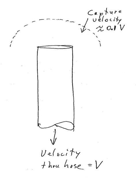

When sucking through a hose with a round end, the capture velocity drops off very fast with distance from the opening. The capture velocity at one diameter from the end of the hose is about 10% of the velocity through the hose. The sketch shows the boundary of about 10% velocity as a dashed line:
Decreasing hose diameter at the suction end increases velocity through the hose at that point, but the restriction decreases total flow through the hose. The end result is worse fume capture at the same total distance from the hose end.
Pretty well inverse square law.
