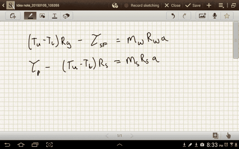

  • #52
Yes I do understand that.
I am still having some issues with the equation though. I can't seem to figure out how to eliminate the chains tension.
  • #53
I am still having some issues with the equation though. I can't seem to figure out how to eliminate the chains tension.View attachment 87196
Solve your second equation for (Tu - Tl), and then substitute it into your first equation.
By the way, do you really think that the rotational inertia of the pedal assembly is significant?
Chet

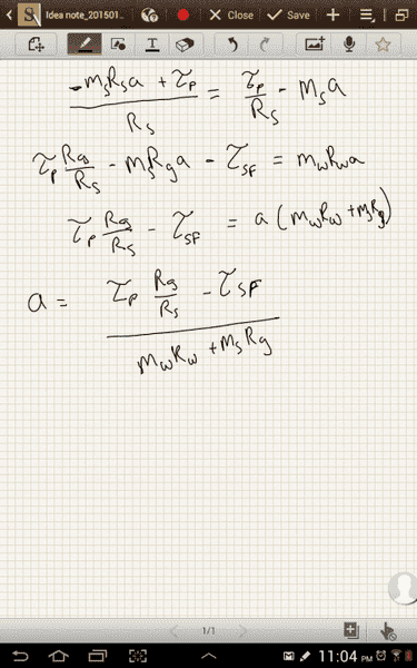

  • #54
So I solved for acceleration and this is what I obtained.
I am still not sure I understand the concept though. And the inertia of the pedal assembly is insignificant?
  • #55
That's because you didn't replace the torque that the ground exerts on the rear wheel τs in your equations with its value expressed in terms of the mass and acceleration of the rider and bike, and of the radius of the rear wheel:$$τ_S=MaR_W$$
where M is the total mass of bike plus rider.
If this is substituted into your equation, you get:
$$τ_p\frac{R_g}{R_s}-MaR_W=a(m_WR_W+m_pR_p)$$
where Rs is the radius of the pedal sprocket, and mp and Rp are the mass and the radius of gyration of the pedal assembly, respectively. So, solving this equation for the acceleration gives:
$$a=\frac{τ_p}{R_W(M+m_W+m_pR_p/R_W)}\frac{R_g}{R_s}$$
I hope this makes more sense to you. It shows how the acceleration of the rider and bike is quantitatively related to the torque the rider puts on the pedal.
To get an idea of how significant the inertia of the pedal assembly is, ask yourself how much effort it would take to turn the pedal assembly if the chain were not attached.
Chet

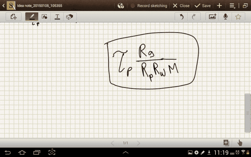

  • #58

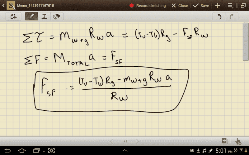

Is there any way to express the force the chain applies only in terms of the pedal force? Using the equations we have, I can only express in terms of acceleration,
moment of inertia, and the pedal force.
  • #59
To get the acceleration out of there, combine the 2nd equation in post #52 with the third equation in post #55.
Chet

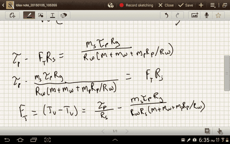

  • #60
So I did that and this is what I got.
Can I simplify this more? Is there a way I can find the force of the chain solely in terms of the force of the pedal and their respective radii? And likewise, is there a way to find the force of static fricition solely in terms of the force of the chain on the rear gear and the radii of the wheel and rear gear?
  • #61
When you ask about the force of the chain, are you referring to the force in the upper part of the chain, the force in the lower part of the chain, their difference, or their sum?
Chet

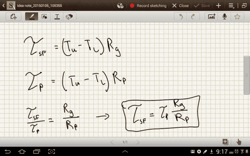

  • #65
Right. So, is there a way to calculate the difference in the two force based soley on the applied force on the pedal and the radii of the pedal and pedal sprocket? Similarly is a way to calculate the forcd of static friction soley based on this difference of the two tensions and the radii of the rear gear and rear wheel?
I am trying to find proof for why, as haruspex said, the torque of static friction lags behind the torque the chain puts on the wheel.
Earlier my calculation for the force of static friction was: (Tu-Tl)Rg/Rw. But this cannot be the case, because it were you'd have break the maximum force of static friction to get the bike to accelerate.
  • #66
Chestermiller said:
The vector sum of the tensions in the upper and lower parts of the chain are determined mainly be the preloading of the chain. Prior to riding, the tensions in both sections of the chain are equal, and pulling forward on the rear wheel assembly and backward on the front pedal assembly. When the bike is accelerating, the tension in the upper part of the chain increases, while the tension in the lower part of the chain decreases.
This is not correct for real bicycles and real chains. For a typical multi-speed bicycle using derailleur gears the bottom portion of the chain is kept at a low and more-or-less fixed tension with a spring-loaded tensioner. You can see several relevant pictures here. https://en.wikipedia.org/wiki/Derailleur_gears
For a three-speed bicycle or a single-speed bicycle pedaled in the forward direction, the situation is similar. The lower chain is essentially slack. The only tension is that resulting from its sag under gravity.
[If the frame were perfectly rigid and the chain were perfectly unstretchable and there were no slack then the situation would be statically indeterminate with no way to determine tension in both chain segments and compression in the frame, even given perfect information about the bicycle. The slack in the bottom chain avoids this difficulty]
What changes when you pedal harder is the tension in the top chain and the compression in the parallel frame member. But the point of application of the force from the frame is exactly at the two axes of rotation -- the hub of the rear wheel and the hub of the crank. So frame compression is irrelevant when computing torques.
Likes Chestermiller
  • #67
You already have that if you are willing to make the reasonable assumption that the rotational inertia of the pedal assembly is negligible.
You already have to equations necessary to determine that.
The lag is probably not very important, but probably depends on how long it takes the tire and chain to deform. But why don't you just ask him?
On what basis do you say this? Did you divide the force of static friction that you calculate by the normal force (which is on the order of the weight of the rider plus bike) and compare the quotient to the coefficient of static friction?
Chet

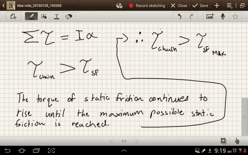

  • #86
It has to in order give a torque greater than the torque of static friction according to the equation.
  • #87
I must be missing something. You apply a torque to the pedal, and it causes a corresponding torque to be applied by the ground to the rear wheel (to accelerate the bike). You hold the torque on the pedal constant while the bike is accelerating, and the corresponding torque applied by the ground to the rear wheel stays constant. So, what's the problem?
Chet
  • #88
In order for the wheel to rotationally accelerate the torque of the chain MUST be greater than the torque of static friction. Based on that equation the only way that can happen is if maximum static friction value is attained. Otherwise, static frictions torque would continue to match the torque of the chain, meaning no angular acceleration.

  • #95
The equation is based on neglecting moment of inertia and taking the torques to be equal, but they are not. They are negligibly different as you say...but they are still different.
So what equation indicates that the torque of the chain is little higher than the torque of static friction.
  • #96
Your own first equation in post #52.
