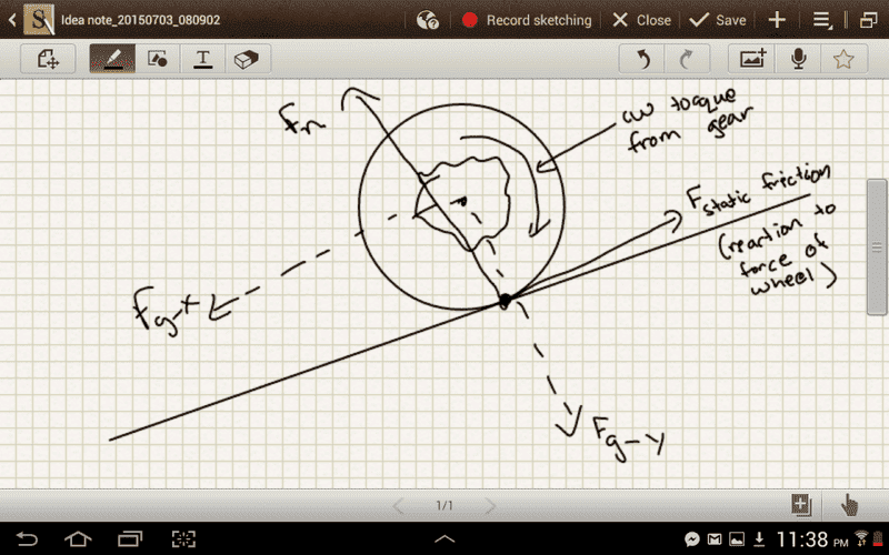

What is the force trying to make it slip? I know its kind of messy, but is this how the FBD would look?
Also, if this is correct, I don't understand why the slipping force is freater uphill. And in order for friction to produce cw torque it must be in this direction. But then wouldn't that mean that the force of the bicycle wheel must be in the opposite direction? How can that be?

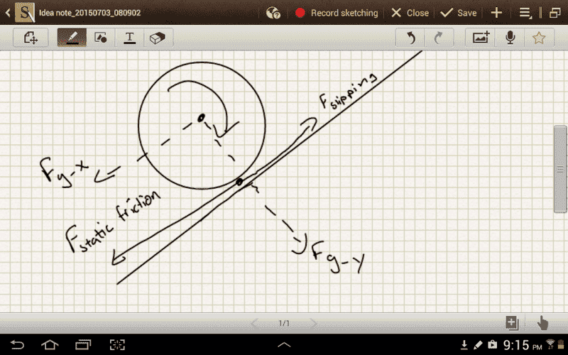

I don't think I understand the exact mechanics of this. Is this what is going on?
If this is what's going on, then static friction supplies the angular acceleration needed for going up the hill. Where does gravity and the force applied by the bicycle come into play?
You really need to work on your free body diagrams. In this case, you have not shown which body you are making a free body diagram of. Is it the wheel or the ground? The force from the ground on the wheel is in the forward direction. And slipping really is not a force.
The diagram is on the wheel. Wouldn't the force from friction be in the backward direction in order to supply clockwise torque though? And what would be the force that creates the slipping then? Or is slipping a lack of force?
Then it is simply wrong. The torque in the clockwise direction is provided by the chain. The force from the ground on the wheel is what accelerates the entire bike in the end. It must be in the forward direction.

And what exactly happens when the bicycle slips down the hill? If you are in a small gear, then you have small output force which means you get less static friction. So then is it that because you get less static friction, gravity's x-component supplies a net force causing a downward acceleration?
The tire exerts a force onto the ground equal to 50N. It can also be said that the ground exerts a 50N force on the tire. If this is the only force acting on the bike in the x-direction, then the bike will accelerate in the x-direction. If not, then you must sum all of the forces acting in the X-direction. The bike will accelerate if there is any net force. Opposition forces include drag, and rolling resistance.

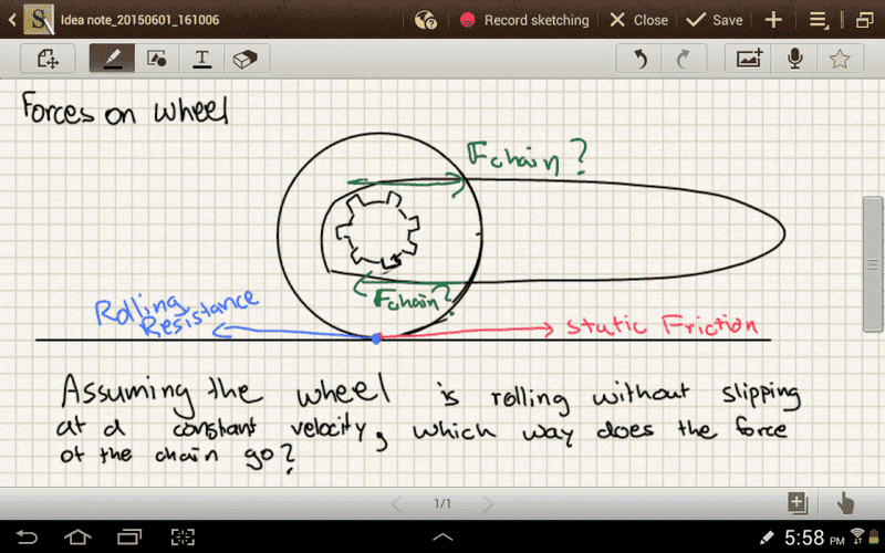

But isn't the force of the chain also acting on the wheel? And if the net force is provided by the ground, then how come the acceleration of the wheel is cw and not ccw?
You just gave the force of the chain acting on the wheel. How are you still confused about it? The chain simply transmits the linear force from one gear to the other. The radius of the gear about its fixed axis makes it a torque applied to the wheel, and the radius of the wheel changes it back into a linear force.
Also, I don't know what cw and ccw are. So, I can't answer that question, yet.
One of the things I think you're having problems with is your free body diagram. Free body diagrams are only meant to view a single body. I think you may be confusing the equal and opposite forces at work with some idea that they may be canceling each other out. They are not. In the end, the tire exerts a force on the ground at that force causes the acceleration of the bike as a system. There is no need to consider the ground, the chain, the foot on the pedal. Once you know that the force is being exerted out of the system, then you know that the system is accelerating.
There's a lot going on internally that gets that force to the tire, but looking at the system as a whole... as a single body, it is exerting a force, and as long as it is greater than the net forces acting against it, the system is undergoing acceleration.

I understand that, but in this I am considering the system to be the wheel, not the bike. So if the wheel is being considered, the force of the chain must be considered.
By cw and ccw, I mean clockwise and counterclockwise. So what I mean is, if the force of static friction from the ground is what provides the net force on the wheel, it must also therefore provide a net torque, right? And if that is true, wouldn't the acceleration of the wheel be counterclockwise instead if clockwise as it should be?
  • #32
The net force on the wheel is the sum of all forces on the wheel.
No, same as above. The net torque on the wheel is the sum of all torques on the wheel.
