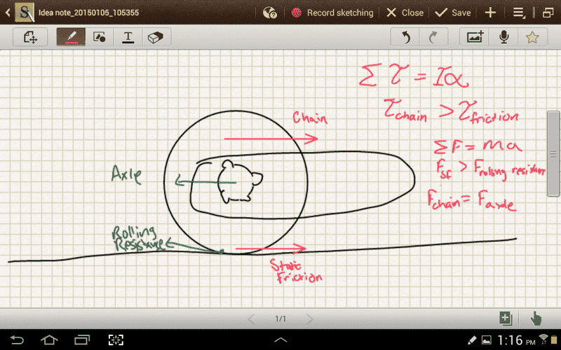

I tink I still have some confusion regarding the free body diagram at a constant velocity.
Which way would the force of the chain go? Or does it cancel itself out while still providing a torque?
I think your diagram has the right idea except for the "F" underneath the back sprocket. The chain is more or less slack there, supporting only its own weight and you can neglect this force and there is no "cancellation" or there would be no net torque. Cast your memory back to a normal bicycle. The chain is usually in tension along the top and it is in front of the back wheel. The chain is pulling against the top of the back sprocket, producing a force on the ground in a backwards direction (a continuous lever, using the spindle as a fulcrum). Friction with the ground provides a reaction force (against the tyre force) which is Forwards from the Bike's point of view. Rolling resistance appears as a force which will slow down the bike (i.e. a backwards force) but it is quite likely not to be horizontal, but to act at an angle to the ground (as I said earlier, the tyre undergoes a constant process of being squashed and having to be driven , effectively uphill all the time. The footprint always has a finite area so the tyre has a flat part in contact and the surface of the road will always provide a series of tiny hills for the wheel to climb. The torque, resulting from this, will be against the torque produced by the chain. There will also be drag from the air and friction inside the bearings. All of that constitutes rolling resistance.

As sophiecentaur said, the bottom force at the sprocket doesn't make sense. A chain cannot push, just pull. So if anything it would go the other way, but be much smaller than the top force, merely supporting the weight of the lower chain.
Also, rolling resistance cannot be localized at the contact point. The way you drew it would create a torque that drives the wheel forward. I would rather draw it at the center of the wheel.

The rolling resistance force that you compute using the rolling resistance coefficient is horizontal (parallel to surface):
https://en.wikipedia.org/wiki/Rolling_resistance#Rolling_resistance_coefficient
I would disagree. The resistance is a torque, rather than a force. As I mentioned, a lot of the loss is because of the distortion of the tyre. Why should that just be a horizontal force? In the case of bearing resistance, it is definitely not a 'backward' force. Having said that, it may be convenient to characterise the resistance as a single force but that is really just a short cut.

But if the force of the chain is in the same direction of static friction..wouldn't there be a net force on the wheel? Does this mean that the rolling resistance is equivalent to the combined force of static friction and the force of the chain?
If this is the case, what exactly would happen had there been no static friction? The force of the chain would provide both a net torque and a net force. Why then is static friction necessary?
You forgot the force on the axle, from the frame.

Wait so if the force of the chain is canceled out by the force of the axle. How then does produce a torque?
  • #52
The force on the axle has zero moment arm ...

So although the chain produces no net force, it provides a net torque when the bike accelerates to start moving. But that brings another question. If the chain provides a torque greater than that of static friction. Then that must mean that the force imparted from the bicycle wheel on the ground must be greater that the force of static friction on the wheel. But wouldn't that go against Newton's 3rd Law?
Also, when the force of the wheel on the ground is partially downwards, and partially to the left right? Does this mean that there both a reaction force from the normal force and the force of static friction?

"Net force" is the sum of all forces, which is zero for constant speed. The total chain force on the wheel is not necessarily zero.
No it doesn't mean that.
The ground force on the wheels has a vertical component that balances the weight of the bike.
