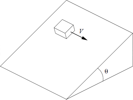

A block is placed on a plane inclined at an angle θ. The coefficient of friction between the block and the plane is µ = tan θ. The block is given a kick so that it initially moves with speed V horizontally along the plane (that is, in the direction perpendicular to the direction pointing straight down the plane). What is the speed of the block after a very long time?
The force of friction exactly balances the gravitational force along the incline. So there will be no acceleration along the inclined plane and the trajectory of the block must be a straight line and it continues to move in its original direction of motion. The frictional force will act opposite to its velocity and after a long time the block should stop. So the final velocity should be 0. But this is not the correct answer. I can't figure out what's wrong with my reasoning.
You are ignoring the fact that the force of kinetic friction is always aligned with the velocity. So initially it is purely horizontal and does not oppose the force of gravity that pulls the block sideways, so the velocity vector gets a sideways component, so does the force of friction, etc.

So how should I proceed?
The first step here would be to write down the components of the net force acting on the particle in the plane of the incline.
The net force is mgsinα down the incline and frictional force = mgsinα opposite the direction of initial velocity
It would be useful to have that written as differential equations.
utkarshakash said:
The net force is mgsinα down the incline and frictional force = mgsinα opposite the direction of [STRIKE]initial [/STRIKE]velocity
The force of friction is opposite to the instantaneous velocity.

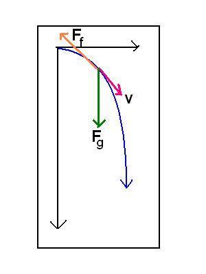

Cartesian coordinates might be used, too, and that approach might be more familiar to the OP.
The x-axis is horizontal, directed along the initial velocity. The y-axis is parallel with the slope, pointing downward. See picture.
The downward force is Fg=mgsinθ. The magnitude of the force of friction is also mgsinθ. The force of friction is opposite to the velocity v. It can be written as the negative of the magnitude multiplied by the unit vector in the direction of the velocity $$\vec F_f=-mgsinθ \frac{\vec v}{v}$$
If vx, vy are the components of the velocity and v is the speed ## v= \sqrt{v_x^2+v_y^2}## the horizontal component of the friction is ##-mg\sinθ \frac{v_x}{v}## and the vertical component is ##-mg\sinθ \frac{v_y}{v}##.
Write out the x and y components of acceleration, and also the time derivative of the speed v. Use the notation A=gsinθ.
$$\dot v_x=-A\frac{v_x}{v}$$
$$\dot v_y=A(1-\frac{v_y}{v})$$
$$\dot v=\frac{v_x \dot v_x +v_y \dot v_y}{v}$$
Substitute the first two equations for vx, vy into the third one. You will see that the time derivative of vy is equal and opposite to that of v. Integrate.
It can be proved mathematically, but it is clear that the horizontal component of the velocity tends to zero with time, so the speed becomes equal to the vertical velocity component v→vy.
ehild
