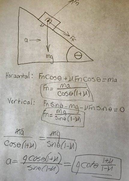

I looked over my work and got a slightly different answer. I now have gcot(o)((1 + u)/(1 - u))
Anyway, here is my work so far and the question. I would think that the work that I did would give me the lowest value of a in the range. Then to get the highest value I would do the same thing expect with the frictional force acting in the opposite direction.

Check your uses of sine and cosine. I find it helps to consider extreme cases. E.g. if θ=0, what would the horizontal component of the normal force be? With experience, you might also recognise that equations involving friction generally have terms FN and FNμ with different trig functions, not the same one.

I switched the cos and sin on the normal force. I had those mixed up. Now my answer for the lowest value of a is
a = g((sin(o) + ucos(o))/(cos(o) - usin(o)))

That is certainly one critical value, but how do you conclude it is the lowest of the range?

My bad, I now think it should be the highest possible value because I chose the frictional force to be acting down the incline. If I do the same thing with the frictional force acting up the incline, I think I will get the lowest possible value.

I now have a = g((sin(o) - ucos(o))/(cos(o) + usin(o))) for the low value, and a = g((sin(o) + ucos(o))/(cos(o) - usin(o))) for the high value. I’m not quite sure what they want when they ask for the special angles. Is it just the angle where the lowest value is equal to 0 and the angle where there is a vertical asymptote?

After plugging that in for the lower value I got a = 0.
So would one of the angles be arctan(μ), being the smallest angle that the block can remain stationary on the rightward accelerating plane?
And then the other arccot(μ), being the angle at which the block can no longer remain on the plane?

No. The equation in this case is for the least acceleration consistent with staying put, and that value of the angle says that that least acceleration is zero.

No. The equation in this case is for the largest acceleration at which it will stay put. The value arccot(μ) gives an infinite acceleration. So with that angle, at what acceleration would the mass slip?

The block shouldn’t slip regardless of the acceleration at that point.
So arctan(μ) and arccot(μ) should be the special angles, the former being the angle where the lowest value of a is 0, and the latter being where there is no value of a too large for the block to remain stationary relative to the plane.

It was not specifically μ>1, but considering large μ made me realize we have something not quite right in the first part of the question.
Writing tan(α) for μ your min and max expressions become ##\tan(\theta-\alpha)\leq\frac ag\leq\tan(\theta+\alpha)##.
What if ##\theta+\alpha>\frac \pi 2##?##

I’m not quite sure where the a is coming from. The interesting values seem to come when I plug in tan(theta) and cot(theta) in for μ rather than tan(a).
I think I might see what you’re talking about though. The highest value of a where the block can remain at rest approaches infinity, but then if the angle is large enough, that value of a becomes negative and lies to the right of the asymptote. I’m not quite sure why this is happening. Is my second equation wrong?

It is incomplete, in the sense that the equation is only valid over a certain range.
Can you tell me what is wrong with this statement:
"If a body is not sliding on a surface with which it is in contact under a normal force N then the frictional force is μsN"

The frictional force is not necessarily equal to that value, but can resist a force that is less than or equal to it.

Right. So how would you qualify the equation?

For the equation that gives the highest value of a, would it just be theta < arccot(u)?

You need to break it into cases. If cot(θ)>μ then ... else ...

Would the equation for the high value of a work for all angles between 0 and arccot(u) and then all angles between arccot(u) and 90 have no maximum value of a for which the block doesn’t rest on the plane?

Yes.

I understand conceptually why this is the case, but can you explain mathmatecally why the equation I found works for some value but not others, and how to figure out which values work?

Your derivation assumed the frictional force was μsN. That is valid as long as the acceleration can be made so large that such a high frictional force is needed. When that is no longer true the equation is incorrect.
