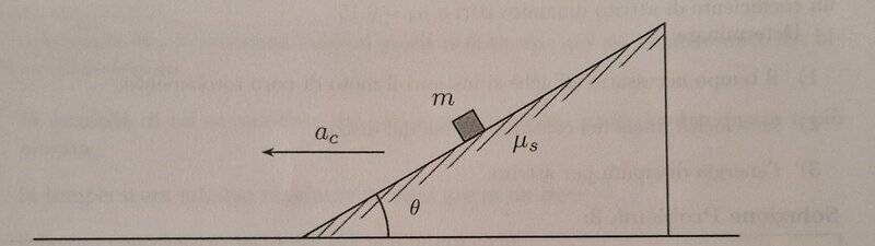

A block of mass ##m## is placed on an inclined plane of height, ##h##. In particular the block is placed at a height of ##h/2##. The surface of the inclined plane is rough, characterized by a coefficient of static friction, ##\mu_s##. Initially both the inclined plane and the block are at rest.
1) Knowing that ##\theta = 30°##, determine the minimum value of ##\mu_s## such that the system doesn't move.
2) Now suppose to drag the system (block + inclined plane) to the left so that it has a constant acceleration ##a_c##. Knowing that ##\mu_s## is the same as found in point 1 and that there is no friction between the inclined plane and the horizontal plane, Determine:
the maximum value of ##a_c## that allows the block to remain in contact with the inclined plane.

As for point 2, I don't understand how I should proceed forward. I don't know how to analyze the system if the inclined plane is moving.
Proceed the same way as before except that you have an acceleration on the other side instead of zero.

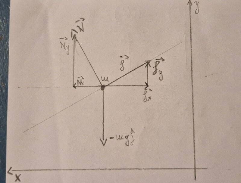

Please post your free body diagram so that we have something to talk about.
Approximately it should be like this.
The frictional force is providing the acceleration of the small block as seen in the inertial frame. I think it will
Be pointing the other way, but you’ll get a negative result.
I’d resolve forces (and acceleration) parallel and normal to the slope, but as long as you are careful that is personal preference.
Likes Thermofox

Thermofox said:
I checked again, but I cannot find the sign mistakes. I suppose that if the acceleration exceeds the maximum limit, the friction force won't be able to maintain the block still. Thus the block will move to the left.
If the acceleration is too great, which way will the block move relative to the slope?
Likes Thermofox
The block will slide down the slope
Sure?
Consider zero slope to start with. The (flat) "wedge" is accelerating to the left. If the block slips, which way will it move relative to the wedge?
Likes Thermofox
haruspex said:
Sure?
Ohhh now I see it. If the slope is zero the block will move to the right, if the slope is ##\theta## the block will move up the slope.
Likes erobz
To complete the picture.
The free body diagram in post #15, as drawn, results in two equation that you have correctly written down. For part 2, we know that the acceleration increases. We also know that the normal force on the block increases as the acceleration increases. The question is what happens to the force of static friction as the acceleration increases? We know that it adjusts itself to provide the observed acceleration but how?
To answer that question, we solve the two equations, for the force of static friction by eliminating the normal force. With ##\mu_s=\tan\theta##, we get $$f_s=m(\mu_sg-a_c)\cos\theta.$$The expression above says that
  • When ##a_c=0##, ##f_c=\mu_smg\cos\theta.## We already knew that from part (1);
  • As ##a_c## increases, the magnitude of ##f_s## decreases until it reaches zero when ##a_c=\mu_sg.## This is the value of the incline plane's acceleration at which the block will stay on if the incline were frictionless.
  • When ##a_c>\mu_sg##, the force of static reverses direction and points down the incline. As the acceleration, increases, ##f_s## also increases but up to a point. After that point, the block will start sliding uphill.
Now you see that the correct FBD for when the block is on the verge of sliding uphill must have the force of static friction pointing down the incline. This is what I meant in post #12 when I asked you to check your signs.
Likes Thermofox and erobz

What happens when this value is reached?
The block starts moving.
  • #35
Right. This means that the block + incline system have reached a point where they no longer can have the same acceleration and move as one. In other words, the common acceleration has reached a point above which it can longer increase. That's what defines as "maximum". Why can it not increase past that point?
