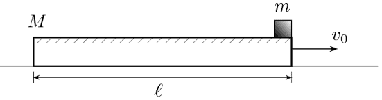

A wooden slab, with a mass of ##M = 80 kg##, initially moves with an uniform rectilinear motion, on a horizontal surface devoid of friction. The slab has a velocity ##v_{s,i}=6 m/s##. At a certain instant, a block, assumed to be a point mass with a mass of ##m = 12 kg##, is placed on the right end of the slab. The block initially has a velocity of zero, relative to a frame of reference fixed to the horizontal surface. Knowing that there is a frictional force characterized by the coefficient of kinetic friction ##μ_k= 0.3## between the slab and the block, determine:
1) the minimum length of the slab such that the block does not fall from it;
2) assuming that now the length is ##l \gt l_{min}##. Determine the time that elapses from when the block is left on the slab and the instant the two bodies will move together.
##\Delta E_m = 0## ##\Delta P = 0##
For the first question I thought of using an energy balance,
there is friction ##\Rightarrow \Delta E_m = -W_f##. Both at the start and at the end, the block has no velocity. Therefore ##E_{\text{initial}}= \frac 1 2 m_s v_{s,i}^2## and ##E_{\text{final}}= \frac 1 2 m_s v_{s,f}^2##. This means that: $$\frac 1 2 m_s v_{s,f}^2 - \frac 1 2 m_s v_{s,i}^2 = \mu_k m_b g l_{min}$$ From this I can determine ##l_{min}##, but first I need to find a relationship to define ##v_{s,f}##.
That's where I'm stuck at. I tried considering the system as a whole. This means that there is conservation of linear momentum, hence:
##\Delta P = 0 ;P_{\text{final}} - P_{\text{initial}} = 0##. The problem is that ##P_i = m_s v_{s,i}## and ##P_f= m_s v_{s,f}##. This means that the slab maintains the same velocity, but that doesn't make sense. So there must be an error, but I can't see it.
Furthermore, for question 2, since I have to determine time, I think I need to use kinematic. Can I assume that the block moves with an uniform acceleration?

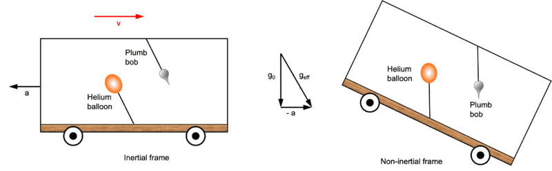

Imagine yourself sitting on the rear end of the moving slab. You look around and you see, far ahead, a block flying towards you just above the top of the slab with speed ##v_{s,i}##. The block lands at the front end of the slab and starts sliding towards you. Because the slab is rough, the block eventually comes to rest just before falling off the rear end of the slab.
To solve this problem, you pretend that you are the observer on the slab, find how much mechanical energy is converted into heat and subtract that from the initial mechanical energy of the cube + slab system in the frame of the frictionless surface. That's what I meant when I wrote

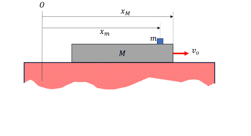

In the horizontal direction ##\rightarrow^+## on the small block of mass ##m##
$$ \sum F = \mu m g = m a_b$$
on the slab of mass ##M##
$$ \sum F = - \mu m g = M a_s $$
IMHO the simple friction model fails this problem(student). ##a_s \neq a_b##
So I would say this:
"is it or is it not true that the mechanical energy converted into heat is ##Q=\mu_kmgd##"
is not true or ## f =\mu N ## is not true.

If you are still having issues ( which I probably had a hand in ) just write some coordinates and apply Newtons Second to each mass as I did in post 15. It's probably not the most efficient as @kuruman proposed, but it's a way.
You can use them to find the time when the velocities ##\dot x_M## and ##\dot x_m## are equal, then you can use the derived position equations to determine ##\ell##.

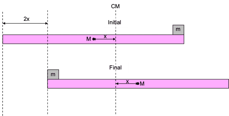

Since we are discussing alternate approaches, one might also consider solving the problem in the CM frame of slab + block (see figure below).
The velocity of the center of mass is ##V_{\text{cm}}=\dfrac{Mv_0}{M+m}.##
The distance ##x## of the slab's midpoint M to the CM is easy to find in terms of ##M##, ##m## and ##L.##
Now, in the CM frame,
The initial velocity of the slab is ##u_0=v_0-V_{\text{cm}}.##
The final velocity of the slab is ##u_{\!f}=0.##
The slab is displaced by ##\Delta s=2x## under constant acceleration ##a_{\text{slab}}##, therefore
##2a_{\text{slab}}\Delta s=u_{\!f}^2-u_0^2.##
This last equation can be solved for the acceleration of the slab in terms of ##M##, ##m## and ##L.##
Finally, one sets ##Ma_{\text{slab}}=\mu_kmg## and solves for ##L##.
On edit:
The answer to part (2) is surprisingly simple, at least to me, but makes sense in retrospect.

This is the standing passenger effect. At the instant the bus comes to a halt, the torque from the frictional force from the floor suddenly goes away and the passenger, who had been bracing against it, falls backwards.
The technical term is jerk, ##\dddot x##.
This is continuous though in (classical) reality?
In any real system there is some elasticity. In a sliding block, there is shear stress as the frictional force is conveyed up through the layers. When the base comes to a stop, the block will take a moment to relax internally.
Likes Thermofox and erobz
The effect is also observed in cars with seated passengers when their car comes to a halt at a stop light. I think is has to do with the sudden change of tactile sensations when the passengers, transit (rather quickly) from being at rest in a non-inertial frame to being at at rest in an inertial frame.
The picture below left shows a schematic bus moving to the right with speed ##v## while braking. The acceleration is to the left. A plumb bob hanging from the ceiling shows the direction of the effective gravity ##g_{\text{eff.}}## which, by definition, is down. A helium balloon taped to the floor points in a direction opposite to down, i.e. up.
The vector diagram in the middle shows how ##g_{\text{eff.}}## is obtained from the acceleration of gravity ##g_0= 9.8~\text{m/s}^2## and the acceleration of the bus.
The diagram on the right shows the physical situation in the non-inertial frame. Standing passengers brace themselves as if they were standing on a floor sloping towards the front of the bus. When the slope suddenly disappears, they find themselves tilted to the left with respect to the floor. Seated passengers (facing front) also feel the change and rotate about their butts with the backrest providing additional torque to stop the rotation.
