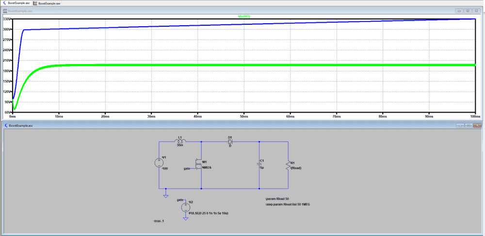

I am trying to find the duty cycle of a boost converter in DCM
Hi, This is not a homework problem, I am trying to analyze how various parameters affect a boost converter operating in DCM most of the time. The input and output voltage is fixed so I will eventually like to sweep parameters for D, L, T, Vi, and R. R is less important though. Here I am using traditional parameter definitions.
D=duty cycle while the switch is on
L=inductance
T=period
Vi=input voltage
Vo=output votlage
R=load resistance
I am trying to find the duty cycle for a boost converter operating in DCM. I've solved for D, where D is the duty cycle while the switch is on. I end up with D=sqrt(-2LVo/(Vi^2RT)), but that doesn't make sense to me because of the negative. I've reworked it multiple times and I keep getting the same result.

I am running simulations but I would ideally like to put an equation behind what I'm seeing. I have other topologies in mind which would require me to modify the traditional boost converter equation, but understanding the boost converter is a good starting point I think. I remember that in CCM there are assumptions that allow you to develop the equations so they're load independent but in DCM that's no longer true and it is then also a function of the load.
There is an equation. As I described. The result is D = (Vo/Vi)⋅√(2⋅L/(T⋅R)). The result in you're OP can't be correct the dimensions aren't right (plus the sign error, which I don't understand).

Can you post a Spice simulation of that scenario please? I'd like to simulate it a bit more to help my understanding. Thanks.
Here you go. I've only simulated out to 100 ms but it can obviously be changed. I think steady state for the no load condition is ~5 s-ish. You can still see that by 100 ms it has reached ~330 V instead compared to 200 V in CCM.
**edit**
nevermind, it will not let me upload LTspice *.asc files. Here is a screenshot. I used L=30 mH, C=5 uF, Rload= 50 Ohm for CCM and 1 MOhm for DCM. Ton=5 us, T=10 us. Vs=100 V. I used the generic nmos with 8000 in parallel (m=8000).
OK, IMO, this is not the sort of generic problem that is not helped by simulation. You won't really understand it without getting the basic operation plus algebraic manipulations right. You are definitely on the right track, I can tell you understand the basic, essential information here. You just need to be more careful with your algebra. Draw some pictures, like a graph of inductor current, to help you keep your signs straight. You are closer to the answer (and, BTW, the right approach) than you may realize.
The LTspice.asc and LTspice.plt files are ascii files. If you change their names by attaching the extension .txt they can be attached to the post by drag and drop as ...
LTspice.asc.txt and LTspice.plt.txt
Look in LTspice dropdown menu Tools. "Copy bitmap to clipboard"; is clearer than screen shot. Attach the picture as a .jpg or .png to reduce size and maintain readability.
