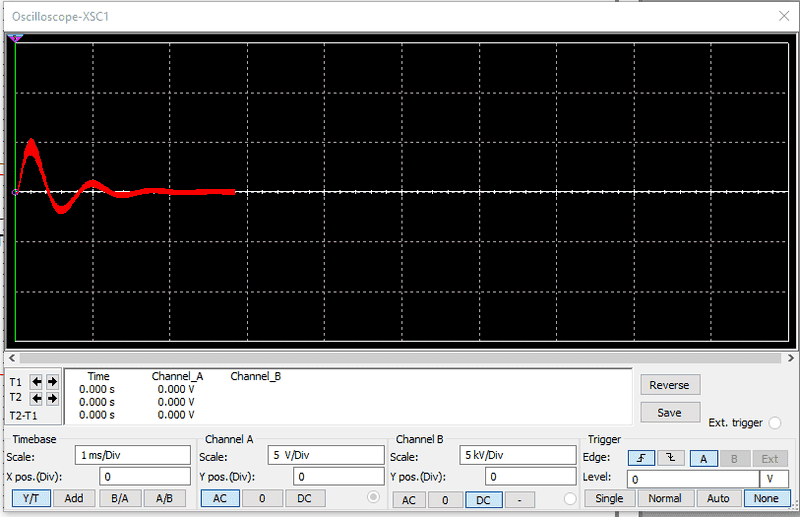

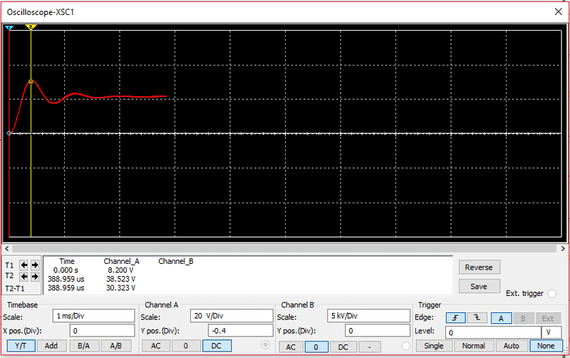

I'm trying to simulate a boost converter using multisim. I get this waveform
Why does it spike like that at the start ?, is it because of the inrush current ?

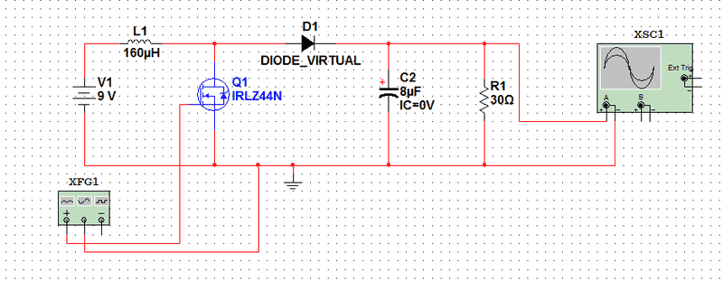

Could you post the schematic and where your probe point is? Can you also post your full startup simulation waveforms? I'm still trying to figure out what that is that you posted.
It's the output voltage waveform from the oscilloscope
I don't see any startup waveform there. It should go vrom 0V up to whatever your target voltage is, and it should take dozens of cycles at least to get there. Can you show the whole waveform from t=0 and V=0?

His measurement is ac coupled, but as you say, it's odd that the initial rise is missing.
OP, what you are seeing is typical of the inrush current caused by charging the dc bus capacitor. For this reason, most boost converters have a controlled startup sequence. You can find plenty of application notes about solutions.

Also, you don't show any closed-loop regulation control of the output voltage. Is that on purpose? You want to run this circuit open-loop and expect no overshoot or line regulation or load regulation issues?
EDIT/ADD -- @TheRedDevil18 -- I didn't mean that to sound aggressive. I'm just trying to understand what you are wanting to do. :smile:
Set your 'oscilloscope' in DC mode.
As the converter starts, the output voltage moves from 0 to ??V. This move has an AC component: with the oscilloscope in AC mode you can measure only this.
In DC mode you will see something like Berkeman linked in #7.

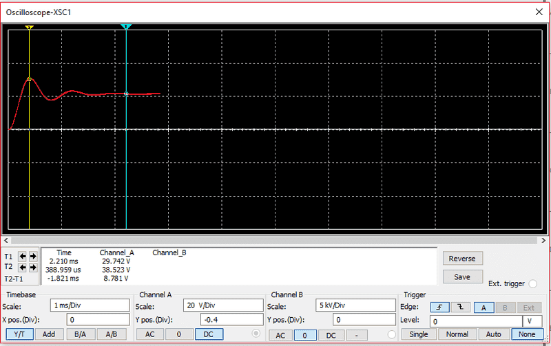

Thanks for the replies, this is my startup waveform with oscilloscope in DC mode
It rises from 8.2 V (not sure how, maybe its the simulator) to 38 V and then stabilizes to roughly 29.5 V. This converter is a 9 to 30 volt. I am planning on adding feedback using an mcu. Will that help ?

Check the schematics: if no control for the FET, then you have closed current loop for the 9V source. It's expected to have a DC current => voltage drop on the resistor.
About the 29.5V: I think you forgot to design for the forward voltage of the diode.

Is the frequency you see in this transient equal to the calculated resonance of your L and C? (Maybe only roughly equal, because the capacitance of ordinary electrolytics has a very high tolerance, possibly a factor of 2.)
Not too sure. I didnt calculate any resonance values. The inductor and capacitor in the simulation are ideal
