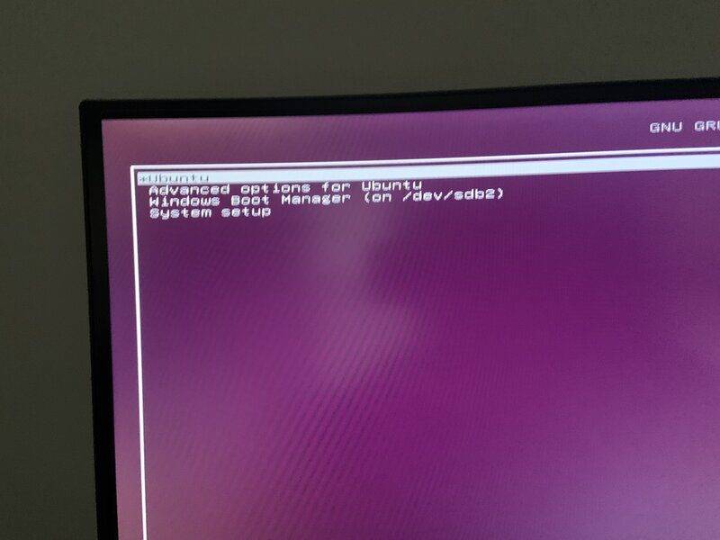

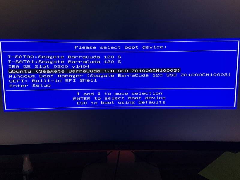

Instead I dual booted on a different machine which runs Ubuntu 18. At startup I'm unsure how to select Ubuntu 14 instead of Ubuntu 18. At startup I get this screen:
I select Ubuntu. Then I get this screen:

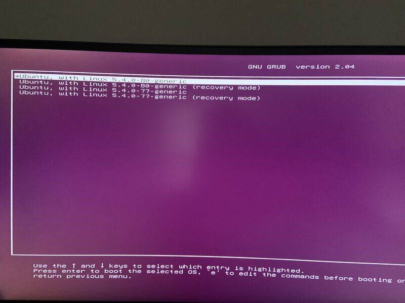

If I select Ubuntu it automatically starts Ubuntu 18. If I select Advanced options I get this screen:
What do I do? I know Ubuntu 14 was correctly installed, and when in Ubuntu 18 I can actually see the partitioning for Ubuntu 14.

You need to tell the grub boot loader about the Ubuntu 14 installation. To do this, boot into Ubuntu 18 and run sudo update-grub and it should detect both Ubuntu installs as well as the Windows install and reconfigure the grub menu (the first purple screen image you posted) appropriately. Then reboot and grub should present you with two 'Ubuntu' options: the second will be Ubuntu 14.

Hey thanks, that did the trick!
