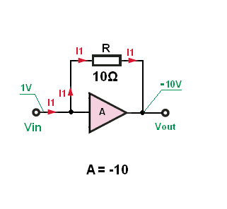

We simply have a ideal voltage amplifier with gain equal to A = -10V/V
Next we connect a resistor R = 10Ω between the input and the output of the amplifier.
Now let as try to find a input resistance.
Rin = Vin/Iin
In = (Vin - Vout)/R = (Vin - A*Vin)/R = Vin * (1 - A)/R
Rin = Vin/Iin = R/(1 - A)
Iin = (1V - (-10V))/10Ω = 1.1A
So Rin = 1V/1.1A = 0.909Ω
So as you can see our Rin resistance is (1 - A) smaller then R if we have inverting amplifier .
And this is what we call a Miller effect

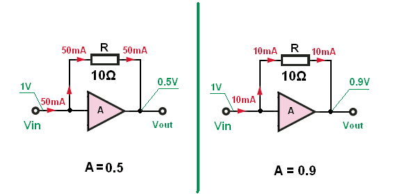

Now let us consider different situation. We replace our amplifier with "voltage follower" amplifier.
But now the gain is equal to A = 0.5V/V
So if Vin = 1V we get 0.5V at the output. So the input current is equal to:
Iin = (Vin - Vout)/R = 0.5V/10Ω = 50mA and therefore
Rin = 1V/50mA = 20Ω
If we increase the gain to 0.9V/V we have
Iin = (Vin - Vout)/R = 0.1V/10Ω = 10mA
So the input resistance is equal to
Rin = 1V/10mA = 100Ω
Also we can use Miller's theorem to find Rin.
Rin = R/(1 - A) = 10Ω/(1 - 0.5) = 20Ω
Rin = R/(1 - A) = 10Ω/(1 - 0.9) = 100Ω
But this time we call this bootstrap
