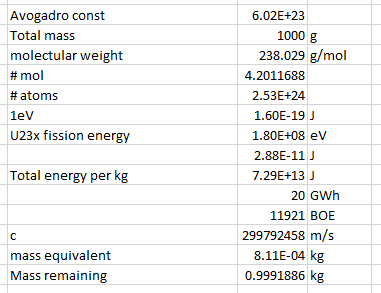

Here's your homework. Assume 180 MeV. And assume 1 kg of pure natural uranium. So count up the number of nuclei in there. Then assume they all fission. And total up the energy released. Then use the e=mc^2 equation and estimate the mass converted to energy by the process. To make it easier, the 180 MeV isn't very accurate. So you can neglect the difference between U238 and U235, assume it's all U238. The error will be less than the error in the 180 MeV.
Interesting:
Interestingly, assuming basically the lost mass is a rounding error, 1kg of Uranium (~19g/cm3) = ~52cm3 of volume, and the fission by products say Zirconium (6.5g/cm3) and Cesium (1.93g/cm3) would imply the fuel would expand in volume by ~4-6x as the Uranium is consumed. Does this cause problems?!

I get a similar result, 0.9992 kg.

So been doing more reading and noodling on this, and seems there are some discrepancies...
First (https://en.wikipedia.org/wiki/Uranium) :
One kilogram of uranium-235 can theoretically produce about 20 terajoules of energy (2×1013 joules), assuming complete fission; as much energy as 1.5 million kilograms (1,500 tonnes) of coal.[6].
This number is about 4x lower than that I calculated above using 180MeV given by @DEvens
Then (https://en.wikipedia.org/wiki/Plutonium-239) :
The fission of one atom of 239Pu generates 207.1 MeV = 3.318 × 10−11 J, i.e. 19.98 TJ/mol = 83.61 TJ/kg,[3] or about 23,222,915 kilowatt hours/kg.
And (https://en.wikipedia.org/wiki/Uranium-235):
The fission of one atom of uranium-235 releases 202.5 MeV = 3.24 × 10−11 J inside the reactor. That corresponds to 19.54 TJ/mol, or 83.14 TJ/kg.
So why do these numbers all not add up? If I take the 202/207MeV number, the energy release I calculated would increase simply because the MeV number went up from 180.
