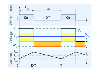

The wikipedia entry for Buck Converter also has some nice instructive waveforms that should help:
http://upload.wikimedia.org/wikiped...Buck_chronogram.png/350px-Buck_chronogram.png

The diode and transistor together act as a switch. When the switch is on, the transistor conducts and the diode does not, so for all intents and purposes the node to the left of the inductor is at vin. when the switch is off, the diode conducts and the transistor does not, so the node to the left of the inductor is at ground.
note that is ignoring the forward drop of the igbt and diode.

You have a good picture of the situation. Actually, V_A(t) is -0.7V when the diode is conducting. But for all practical purposes it's what you said: ground.
When the transistor is ON (q=1), current flows thru the inductor to the load per di/dt = (V_in - V_o)/L. When it's OFF (q= 0), the diode takes over and continues the current thru the inductor and the load. But while the diode is conducing, the inductor current di/dt = (0 - Vout)/L < 0 so depending on your parameter values the L current might decay to zero until the next time the transistor turns ON again. (The current thru L never goes in the opposite direction.)
