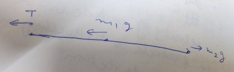

I came up with some analysis that yields the conservation of momentum as is being applied in this scenario. Not sure if my assumption is correct related to the average force ##F_a## during the period when putty finally sticks to the bucket. I have assumed that this average force is going to be very large compared to ##mg## where ##m## is mass of putty. ##M## and ##V## represent the mass of each bucket and final speed of the system just after putty sticks to the bucket. ##v_i## is the velocity of putty just before the sticking process starts.
Likes Steve4Physics and Shreya
Yes, that looks right.
Likes vcsharp2003
A few thoughts…
It is not clear if/where/how/why you have applied the assumption ##F_a>>mg##.
After the ‘collision’:
the momentum of the left bucket is ##MV## upwards (in vector notation ##MV \hat j##);
the momentum of the right bucket is ##MV## downwards (in vector notation ##-MV \hat j##).
Their vector sum is zero, not ‘2MV’.
However, your approach works because you have effectively used the ‘trick’ explained in Post #16! It's a work-around but not rigorous.
Also note, you have treated tension as if it is constant. But tension is different before and after the ‘collision’. I suppose you could say ##T## is the average tension during the collision.
If you are going to skip the "trick" and go with the more rigorous treatment then the collision is an impulsive event and the average tension ##T## during the event is undefined. Instead, we would be interested in the integral of ##T## during the collision. That is, we would care about the impulse delivered by ##T##. Given the geometry of the ideal string and pulley, the delivered impulse would be identical on each bucket of course. (Equal, rather than equal and opposite).
That impulse would be whatever is required to maintain the constraint that the two buckets end up moving at equal and opposite velocities.
I do not recommend such an approach. It is sure to yield the same answer as the trick. The added complexity it not worth the effort. In my opinion anyway. Others are free to disagree.
Likes vcsharp2003, Steve4Physics and Shreya

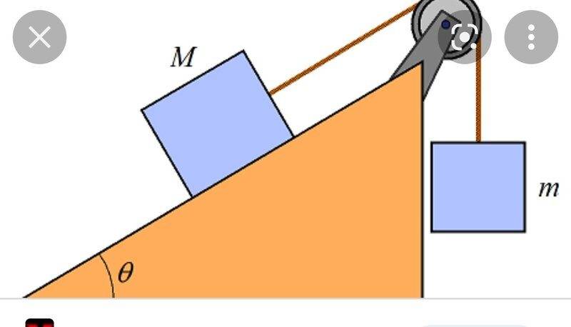

We have consistency. The "straightening trick" helps sort out the instantaneous momentum conservation from the dynamics of this situation and works both ways, from Atwood machine to linear system and back.

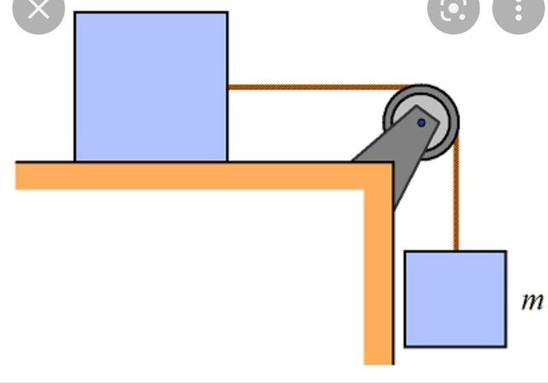

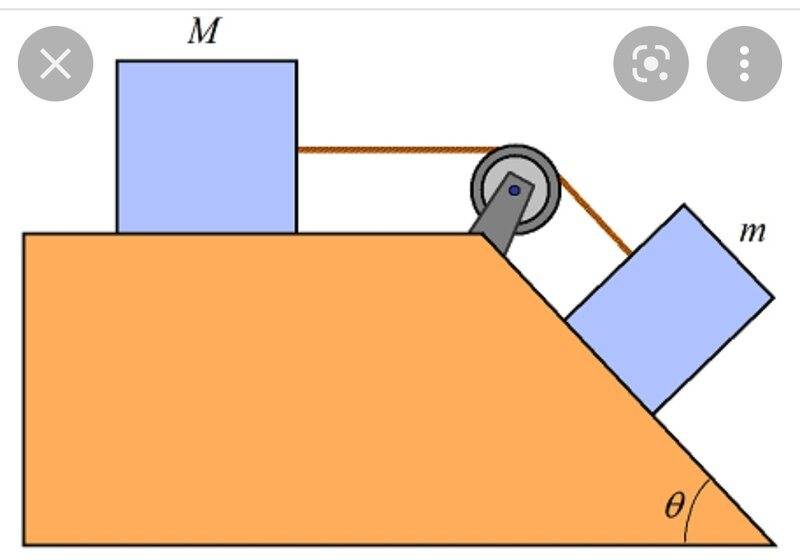

That's a nice trick that helps to solve problems on Atwood machine. But I was wondering if it has a wider applicability when considering masses connected via pulleys like on an incline or more complex cases of Atwood machine as shown in images below. If it could, then this would be an awesome trick in solving many difficult problems.
I tried to apply your straightening trick to first pulley masses system and came up with following straightened string.
View attachment 300435View attachment 300430
Is your graphic solution referring to that image?
If so, you need to consider the effect of the moving pulley on the mechanical advantage or ratio of output force (FG1) to input force (FG2) in this system (mass 1 having half of the speed of mass 2).
You cannot indiscriminately stretch any string with masses and expect the straightening trick to work. Its value depends on the fact that the acceleration of the masses has the same magnitude, in which case you can apply Newton's second law to the entire system and ignore the internal tension. In the multiple pulley examples you have shown (first two figures in #32), the accelerations of the two masses do not have the same magnitude.
You can, however, straighten the string in the last three figures which are the same problem with different incline angles. The "generalized" Atwood machine has two masses each on its own inclined plane. Before straightening, on has to be careful to use the angle of the component of the weight parallel to the original direction of the string as the driving force. In that case, for the generalized Atwood machine, Newton's second law gives $$m_2 g\sin\!\theta_2-m_1g\sin\!\theta_1=(m_1+m_2)a\implies a=\frac{(m_2 \sin\!\theta_2-m_1\sin\!\theta_1)g}{m_1+m_2}.$$To find the magnitude of the acceleration using the expression above,
for the original vertical Atwood machine, set ##\theta_1=\theta_2=90^o##;
for the half-Atwood machine shown in your third figure, set ##\theta_1=0,~\theta_2=90^o##;
for the fourth figure, set ##\theta_1=0,~\theta_2=\theta##;
for the fifth figure, set ##\theta_1=\theta,~\theta_2=90^o##.
Likes Steve4Physics, Lnewqban and vcsharp2003
Thankyou, that's a very useful trick for quicker problem solving when connected masses are having the same acceleration magnitudes. I wasn't aware of this neat trick.
  • #46
It's not really a trick. It's the realization that if you write the one-dimensional equations for the two free body diagrams, you get
##m_2g\sin\!\theta_2-T=m_2a## and ##T-m_1g\sin\!\theta_1=m_1a##. Add the equations to get
##m_2g\sin\!\theta_2-m_1g\sin\!\theta_1=(m_2+m_1)a##. By straightening the string you eliminate the tension graphically instead of algebraically.
