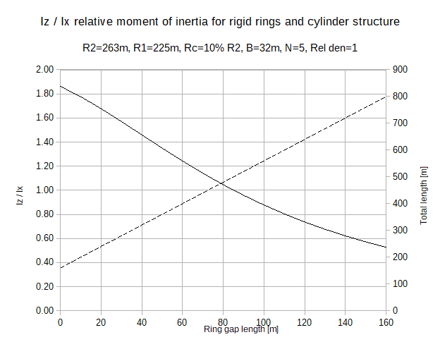

Shape: elongated and thin like a pencil, with five rings for artificial gravity rotating around a "central pipe"
Let me address that a bit.
Free rotation of pencil-shaped mass distributions (i.e. rotation around the minor axis of the principle of moment) are rotationally unstable. Without any active control (e.g. ejection of reaction mass) and giving enough time the structure will end up tumble end-over-end instead. If you want to cater for this fact in your world building you either need to use some active control (doesn't sound feasible on a generation ship), or design the ship so it does not have a pencil-shaped mass distribution.
As an example consider a hollow cylinder of length ##h## with the bulk of its near-constant density mass between radii ##r_1## and ##r_2## rotating along its symmetry axis (an O'Niell cylinder), then for the rotation to be stable you have to have ##h^2 < 3(r_1^2+r_2^2)##. This sets a limit on how long the "pencil" can be.
Later: Since you are aiming for a set of rings it may very well be such a structure can be made much longer (at least geometrically) than a cylinder without getting unstable rotation, assuming a rigid coupling between the rings. If the couplings are only semi-rigid I am not sure if this in itself extend or reduce the critical length of the structure before it becomes unstable. My intuition is fairly sure that if the length of such a structure is above the critical length, then the being semi-rigid means more rotational energy sinks will be present thus speeding up the departure from pure rotation.
Assuming rigid couplings it could be a fun exercise to try calculate the critical length of a stack of rings. :smile:

If radius one is the inner radius of the rings / cylinder (250 metres in my case), what is radius two then? The outer radius of the rings (=on the outermost floor)?
Yes, its the inner and outer radius of the cylinder/ring where the bulk of the mass is located. For example, assuming inner radius 250 m and outer 300 m (just to take some numbers), then a cylinder will become unstable at a length of around 670 m.
If we for the purpose of calculating the rotational stability of a ring structure assume it is like a hollow cylinder sliced up into ##n## slices each ##b## wide and then spaced ##s## apart (from center of one ring to the next) and attached rigidly to a central spindle, then it seems possible to get an expression for how many rings you can have before that structure becomes rotationally unstable around the spindle.
Let me add some equations so others have a chance to verify if they like. The two interesting moments of inertia for a cylinder is $$I_{C_z} = \frac{1}{2}m(r_1^2+r_2^2)$$ and $$I_{C_x}=\frac{1}{12}m (3(r_1^2+r_2^2)+h^2)$$ where ##h## is the length of the cylinder and ##m## the total mass. For a cylinder to be rotational stable around ##z## it requires that ##I_{C_z} > I_{C_x}##, which gives the condition $$h^2 < 3(r_1^2+r_2^2)$$ which I mentioned earlier.
For a ring structure with an even number of rings and using ##h = n b##, I end up with the moments of inertia to be $$I_{R_z} = I_{C_z}$$ and $$I_{R_x} = + \frac{1}{12}m (3(r_1^2+r_2^2)+b^2 + s^2 (n^2 - 1))$$ which means that for stable rotation around ##z## we must have ##I_{R_z} >I_{R_x}## or $$n^2 < \frac{3(r_1^2+r_2^2)-b^2}{s^2} + 1.$$ A similar expression should also be possible to derive for ##n## being odd.
With the numbers from before, i.e. ##r_1 = 250 \,\mathrm{m}##, ##r_2 = 300\,\mathrm{m}## and choosing, say, ##b=50\,\mathrm{m}## and ##s=100\,\mathrm{m}## then I get that ##n < 6.8##, that is ##n=6## should be stable, ##n=7## will probably will be unstable (since this is an equation for even ##n## we need the odd version to be sure) but ##n=8## surely will be unstable.
Note that all this assumes the whole structure is rigid, that is, all the rings are "locked" together. In the other end of the scale we would have that the rings are completely free from each other (ignoring any rocket thrust) which means they each rotate stable as a short cylinder given the expression for the cylinder. A practical ring structure will probably be in between those two extremes of rigidity, that is, some flexing or uncoupling is probably both unavoidable and perhaps even desirable, also to make the spindle more simple.
For instance, one could image that if each ring is mechanically attached to the spindle in such a way that it only absorb translatory forces from the spindle (i.e. rocket thrust) but not any torques and to large degree is free to rotate independently of the other rings, at least direction-wise, then each ring is more or less its own little cylinder and thus very stable in its rotation. This may of course introduce a lot of other engineering complications (like how to actually control the rotation direction of each ring) and design constraints but for a story it can perhaps also allow for more ways to introduce interesting plot twists (I am here considering how common it is in sci-fi to base plot twists on failing equipment :smile: ).

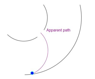

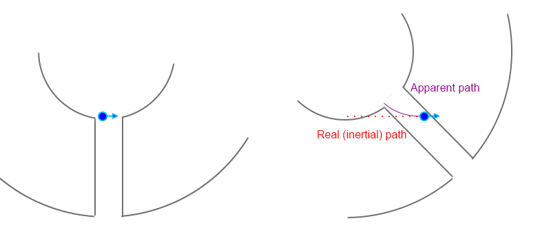

The other thing to consider is that the air mass will rotate. The Coriolis Force will carry objects toward the outer wall.

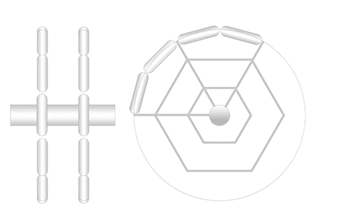

BTW, KSR's "Ship in Aurora did not have continuous rings. They were cylinders linked end-to end with sealable bulkheads.
There is a technical description of it here:
https://www.centauri-dreams.org/2015/08/14/a-science-critique-of-aurora-by-kim-stanley-robinson/
It is 10km long and 17km in diameter and housed ~2000 crew for a ~170 year journey.

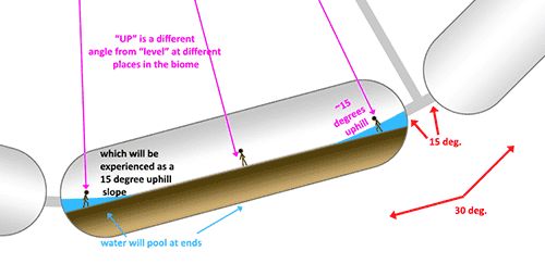

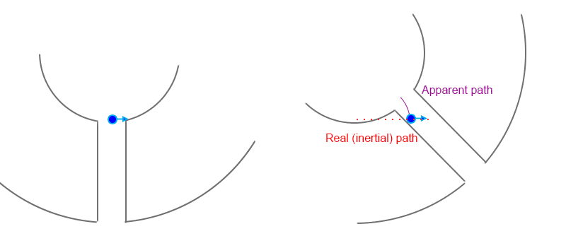

This is an accurate proportional rendering I did of the Aurora ship.
Here is a detail of a cylinder and its funny gravity.
Each cylinder is 4km long and 1km in diameter.
Likes Strato Incendus
What is the reason for a linear crew cylinder? Air pressure? Why not slightly curved due to the structural load from the rotation? I assume, that at least the internal floors or levels are made to be perpendicular to the local "gravity" vector.
Interesting design, though. Perhaps I should put Aurora on my reading list for next vacation :smile: .

Good thing you mention the Coriolis Force again here. :) But I assume that is something I would only get if I have the central pipe rotate indeed. So I cannot have my cake and eat it, too.
It would actually be advantageous to have something that helps people get back towards the walls of the central pipe (or its smaller sub-corridors), so that they can shimmy along some sort of handrail to get forward. I think the natural "floating speed" when moving through it would be pretty slow - and considering that the pipe will have to be anything between several hundred meters or even a few kilometres long, that would mean it takes quite a while to get from home to work, or from work to the canteen.
So the question is: Once you "take flight" within a zero-g central section, how do you get back to the wall? Especially if the pipe needs to have a thickness between 50 and 100 m minimum?
That sounds like another reason why the pipe should be subdivided into smaller corridors, so that you cannot get "lost floating in the middle" all that easily.
Also, I imagine the central pipe to have padded walls.
In general, much like on a space station, everyone on the ship is obsessed with keeping things tied down / locked in place, so that no potentially lethal floating objects can occur.
This is of course especially relevant in the central pipe, where there is no gravity. But even on the rings with standard gravity, if the ship had to slow down "abruptly" (as fast as is reasonably possible from 10% light speed), that could turn anything into a lethal projectile, if I understand it correctly?

Here is what I imagine this to look like (just a non-proportional sketch I made in Photoshop Elements on a Public-Domain background):

Filip Larsen said:
As long as the ratio is above one you should be good. In the plot below that is the solid line with the ratio on the left Y-axis, so (assuming I didn't botch up my equations or spreadsheet too much) gaps less than 80m should be good. The dashed line is for total length with the value on the right Y-axis.
Great, thanks a lot again, especially for the making the graph! :) That is precisely the kind of guidance I was hoping for, to at least get into the right ball park with the ship measurements. Turns out I probably would have made the ship way too long otherwise.
Right now I would go with a between-ring distance of 60 metres each, then.

Does 60 m inter-ring distance still work if I change B from 32 m to 64 m? As far as I understood, the graph you made is specifically for B = 32 m.
Yes, the graph was made for B = 32m specifically, but let me stress again that such a moment of inertia calculation considers only the geometrical distribution of he bulk of the mass, so having some part of the structure protrude from the ring in various directions shouldn't matter much as long as the mass of these protrusions are small compared with the total. The various values used for the graphs just means that the bulk of the mass is assumed to be distributed equally within the geometric shapes these values indicate.
The only places where the pipe does reach its full 100-metre ceiling height now (i.e., the full diameter) is at the hub of the rings. If the hub sections in the pipe rotate, too, I guess this would create some small levels of gravity in those sections of the pipe? They are obviously rotating too slowly to create Earth-like gravity, given their diameter is only 100 metres. But a little gravity in the hub sections of the pipe would actually be helpful to get people towards the elevators - since those four elevators would be rotating around you while you are standing / floating in the central pipe at one of the ring hub. The elevators A-D then travel down the four spokes of each ring.
It is important to keep in mind how "artificial gravity" actually works in this case.
The tendency is not toward the floor; the tendency is tangential to the floor underneath you, but as you move in that direction, the floor will rise up to meet you.
Things that can impart this are contact with the air around you, or contact with the floor or walls.
Without significant contact with any of these things, you will effectively float weightless.
Now, the above diagram is seen from an inertial frame of reference, so you see how it works.
The occupant doesn't see it that way from his rotating frame of reference. The differences are subtle but important.It's difficult to describe in a few paragraphs, but it would benefit your story to read up on it so you get it right.
Thanks for stressing this again and adding a graphical depiction of it! I just checked out that one scene from The Expanse again (pouring water into a glass diagonally) to get an idea. Some people in the comments said the angle were exaggerated, but understanding the idea counts.
In my story, I have a couple of shower scenes that are relevant for the relationship between the leading couple. So I guess the water would fall diagonally in that shower, too? (The showers are part of every quarter and therefore on the habitat ring, of course.)

The problem is, it's very circumstance dependent.
It depends on constants such as radius of the ship and the speed of rotation, but also on variables, such as what direction the target object is moving and what way the observer is facing.
Throwing a baseball spinward will cause it to fall way short.
Throwing a baseball antispinward will cause it to fall long.
Dropping a baseball vertically from your hand will show very little deflection.
A longer vertical drop will show more deflection than a shorter drop.
I've seen this last one used to neutralize (i.e. kill) a lethal enemy* who was not familiar with the subtleties artificial gravity.
*(Kzin Warrior. Kzin have generated artificial gravity and know nothing of Coriolis)What I'd suggest is to make a reference sheet with some samples for your specific constants that span the range of the variables. Maybe someone here can help with that.
Will readers care about that? Well, obviously not if it is just an info dump the author uses to show "hey, look, I've done my research!" :oldbiggrin: But if it becomes plot-relevant, and more specifically, the characters actually use this to factor into their plans, it should both make the story look more plausible and make the characters come off as smart, without having to give them any special abilities, just their human intelligence and combination skills to use their natural environment to their advantage.
Sounds like you've got a handle on good writing techniques.
The deflection is one factor that plays into this scene, but of course, there is also the fact that gravity itself increases as the character falls down the lift shaft. It should thus not be the same as falling down a 200-metre shaft on Earth: Initially, closer to the top, the drop shut be slower.
Be careful here. This is an excellent example of a scenario where you don't want to confuse AG with real gravity.
There is no way a freefalling character will fall down an elevator shaft for any significant distance unless the shaft is impractically wide.
Remember, the character is not really being pulled downward; they are being pulled spinward tangentially - and the ship is rising in front of them to intersect them.
Without the constraint of an elevator shaft, their freefall path would look more like this:
And - for a freefalling character - gravity doesn't really "get stronger" the farther they fall. They effectively stay moving (slowly) with the momentum they started with, but the surfaces they encounter will have increasingly (horizontal) relative velocities the farther outward they go.
If they fall far enough to hit the floor, they will actually impact gently - but the flor will be moving spinward quite fast and they will skid up-to-speed. (see diagram 2, above)
The real danger is having a wall hit them.

  • #45
Indeed. For the benefit of the OP, let me add a disclaimer to my earlier comments about "gravity level" that when talking about that gravity is such and such at this and that distance from the rotation center this almost surely always implies we are talking about something that is stationary or very nearly so relative to the rotating station. In the limit where this is true (i.e. for small speeds relative to the tangential speed at the given radius) a free-fall motion relative to the station will appear to match "normal" gravity. If you make a small jump on the 1G ring of large station the path relative to the floor will look like a parabola well-known from "flat gravity". If something drops from the ceiling it will to a good approximation accelerate towards the floor at around 1G. But if you let something drop for long it will gradually "blend" into this "curved" path Dave so nicely has illustrated.
Minimizing this and other similar "strange" effects caused by the rotation while keeping the overall engineering feasible are usually a key design trade-off in many real-world designs. For instance, I would be surprised if a design for a station with a full 1G for all crew would ever be implemented since its simply too impractical unless it later proves to be absolutely critical for some (yet unknown) medical reason. It seems much more likely to have a lower G-level (i.e. use slower rotation for a given station size) and then use a local "tower" or cabin section that can extend beyond the radius of the main level if special 1G training or similar is needed.

Ring Radius: 250 m
Inner Ring Diameter: 500 m
Outer Ring Diameter: 526 m
Inner Ring Circumference: 1,570 m
Outer Ring Circumference: 1,652 m
Inner Ring Thickness: 32 m
Outer Ring Thickness: 64 m
Angular Velocity: 1.94 rotations per minute
Tangential Velocity: 50.74 meters per second
Centripetal Acceleration: 1.05 g
The radius of the pipe is 50 m (diameter 100 m), as we have established earlier in this thread.
Trying to figure out how many scenarios you'd need to cover all the bases.
I think you'd want fifteen trajectories modeled from the rotating FoR, thus:
For each of three radii:
1] outer ring floor,
2] pipe floor and
3] halfway between
you want
A] High speed spinward
B] Low speed spinward
C] At rest wrt floor
D] Low speed antispinward
E] High speed antispinward
Maybe someone who knows the math better can fill in the numbers.
But, if you are so inclined, it could be done diagrammatically the way I did on post 44.
