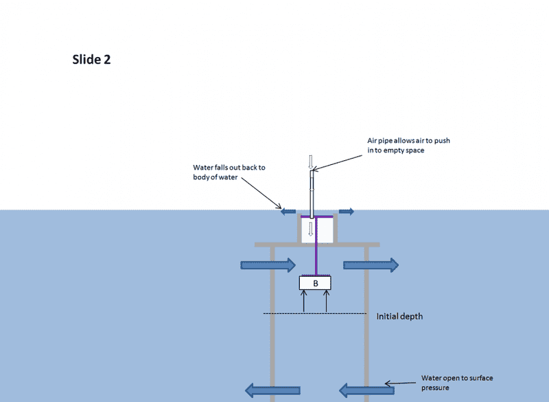

I wanted to inquire as to a thought I have on a situation with buoyancy and air pressure.
In the first slide (slide 1), I am showing a situation where a buoyant object is pushing up on a support wall through a fixed wall that has water in it. Here are the factors:
1. The net buoyant force of the hollow object is 500 N (pushing upward)
2. The support structure is 300N in weight (purple)
3. The support structure is flush up against the inside of the horizontal walls and do not allow passage of water down
4. The friction is 50N (walls against the support structure horizontal wall; the vertical pole through the bottom fixed wall (grey)
My query is... would this buoyant push from the water below be able to push the water up and out to spill over the sides and back into the main body of water leaving the area below empty with just air? I was thinking it would not need the air pipe to allow air to come in and equalize the air pressure since the air is also pushing down on all the water? But I am wrong? I believe that only with the air pipe will the net force upward (500N up minus (300N + 50N) = 150 N --- would be able to push the water up and out leaving the empty space?

Thanks for the input -- my main query is that :
1. Water is raised up in the small tank
2. Air is replaced below? Without the air pipe...it probably a lot more work because of the air pressure above?
Re the first drawing...Without the air pipe the buoyancy force has to create a vacuum in the top container - so it would have to overcome the head of water in the top container plus atmospheric pressure.
With the air pipe just the head of water.

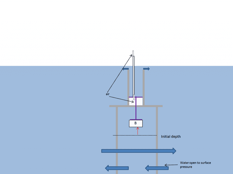

So I am a little confused still on what the buoyant force can do. I know there is a buoyant force pushing up on the water in the container. With these following numbers :
Net buoyant force of the hollow object (including weight of materials = 1000N
Weight of purple structure = 200 N
Friction = 20N
Force of water above in container = 4000 N
Can the buoyant force lift up only the volume of water equal to itself (i.e. the volume of empty space )? Or it can't lift any of the water up because the weight of the water is much greater?
When an object is immersed in water, there is an upwards force on it equal to the weight (mg) of the water displaced.
There will also be downwards forces on it - like the weight of whatever the immersed object is made of and the weight of whatever the immersed object is supposed to support.
In your example (above) you have 4200N down and only 1000N up - so, even without friction, the net force is downwards, so float B will sink under the weight.
