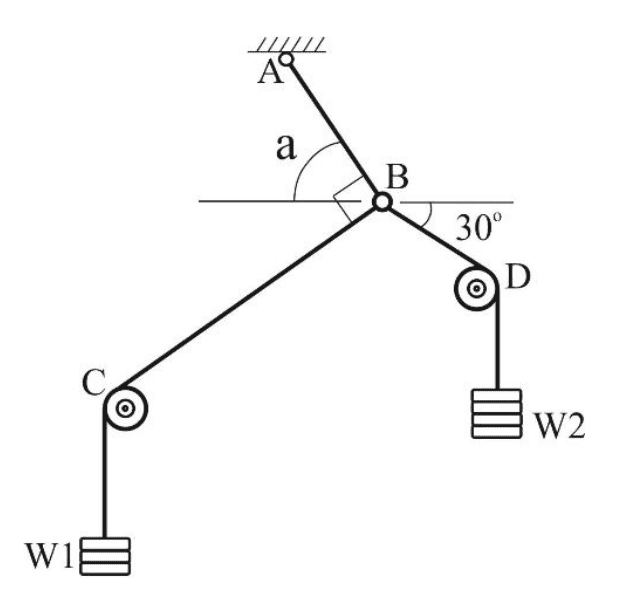

I've been struggling with this question for a while now, and for the life of me i cant see what i'm missing, the picture is in the solution attempt along with the equations i've been using. Any assistance would be amazing. Find: Tension AB and Angle a
W1 = 330g
W2 = 440g
Fx = 0 = ABcos(a)+BCcos(b)-BDcos(30)
Fy = 0 = ABsin(a)+BCsin(b)-BDsin(30)
Fx = 0 = ABcos(a) + 3.2737cos(b) - 3.738
Fy = 0 = ABsin(a) + 3.237sin(b) - 2.158
But i cant find a third equation to use. I've tried a+b = 90 but that produced a number of errors. Thank you.
Edit: angle b is the angle string CB makes with horizontal

Finding the tension AB is easy. You are missing that when the sum of N vectors is zero and you draw the vector addition diagram, the ensuing shape is a closed polygon with N sides. Apply this idea here.
Thank you sir, got it all fixed up now, didn't even think to go about it that way, earlier response was a brain fart as its quite early in the morning and i haven't had a coffee yet.
