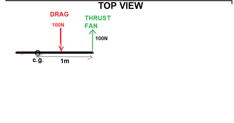

I want to calculate center of rotation for monocopter, from inertial reference frame,earth.
One case when fly in the air in one steady height/place and second case is in free space,then has rocket engine instead fan.
I draw forces what I think that must exist.
m=2kg
Ft(thurst)= 100N
ω=500RPM
Can I find center with this data or I need more informations?
Axioms:
  1. A pure force thorugh the center of mass (with no net torque about the center of mass) will purely translate a rigid body (any point on the body).
  2. A pure torque any point on the body (with no net force) will purely rotate a rigid body about its center of mass.
Space case
(I am in space station near the stick wich is at rest, then I start rocket engine of stick and observing, neglect loss in fuel mass)
I have only one force and mass, so I know Fnet must be non zero.I know that CoM will not accelerate in straight line, because force dont going through CoM.
I also know that object cant rotate around CoM because of Fnet is non zero .
So Fnet is non zero implies, that CoM must orbit around some point but I don have centripetal force for this movement
I am stuck in my contradictions, obviously my reasoning is wrong because physics laws must be true.
What I am doing wrong?

user079622 said:
Maybe is better to focus on first case in space.
Isn't it the same, just without the drag?
Yes only drag.
Maybe is this case even easier.
I can delete left drag arrow and mathematicaly show that as shift in drag at wing to the right,
when drag equal thrust Fnet is zero, and we have pure rotation around c.g., zero translation.
So we manage to put center of rotation at c.g. that mean monocopter stay in place stable.
What do you think?

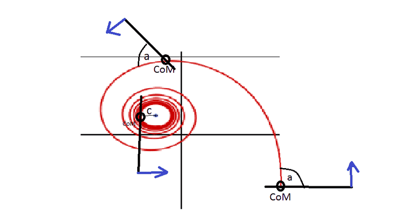

Left trajectory is how my case in space will look like.
As RPM increase, linear acceleration of CoM decrease, so point around which CoM orbit become smaller and smaller.
Or I can say intuitively when RPM increase force vector point in each dircetion, so stick going toward pure rotation.
Will it end up in pure rotation around CoM or CoM will orbit around center of smallest circle?

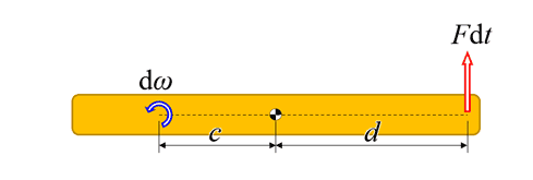

Like this?
Space case
c=Icm/md=k^2/d
Com trajectory is Euler spiral, during path angle a is reducing, in final stage CoM rotate around point c, rod is tangent to that circle.
Angle a decrease
I thought that the thread is about the center of rotation.
My graph is wrong, c is not center or rotation. I made mistake.
I am giving up on this task, it looks trivial (one rod with just one force) but it turn out it is damn complex.
