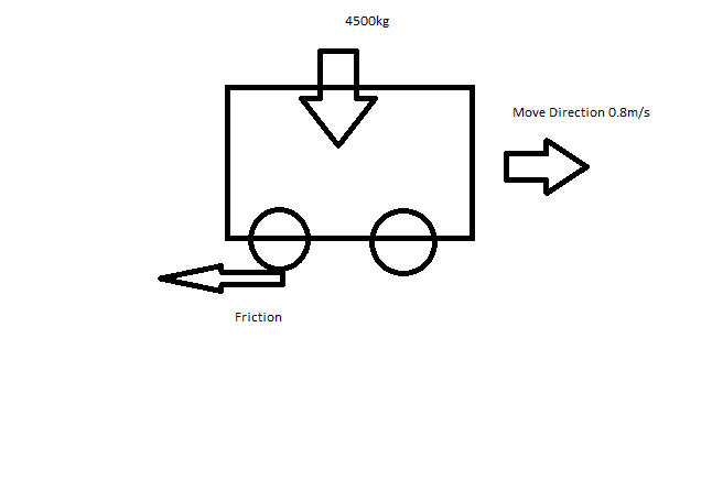

billy_joule said:
Draw a free body diagram showing all forces acting.
At constant speed all forces sum to zero.
Or in other words, the torque applied by the motor will be equal and opposite to the torque from friction/s.

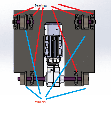

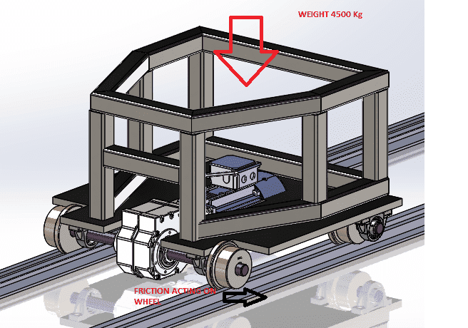

This is not a home work. Actually i want design this and fabricate.Hear i have attache my rough 3D drawing views.could you please explain the way i want to follow. The cart start at 0 m/s and i want to move it 20m in 0.8m/s speed and stop.
Thank you.
Udaya.
Udaya said:
Hello Billy,
Thank you.
Udaya.
That FBD is poor - where is Bearing friction? Normal force?
That design is also poor and brings a lot of questions to mind.
How do you intend to power the motor? Why is the motor on the cart at all? why not stationary motor with chain or cable drive? Are the lateral forces during loading? What thrust loading will your bearings experience? Why isn't the motor parallel to the axle? why 0.8m/s? Why are the driven wheels so poorly supported? Why does the cart have a massive plate section? Why does the frame have no members to stop skewing? Why is such large box section used for the frame? Why ca't you use an off-the-shelf gantry like you'll see in most engineering workshops rather than design and build a cart? Or buy a cheap second hand forklift? I could go on..
Overall I think there are probably many better ways to solve your problem, I suggest you have an engineer look over your problem and design/find a more appropriate solution.
If you can define your problem with as much detail as possible someone on this forum may be able to suggest solutions.
As it is we can't help much, it looks like you haven't thought this through much and jumped on the first idea that came to mind.
