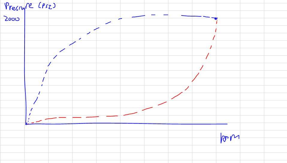

I can easily see myself going from 0 RPM to 500 RPM by flooring the gas pedal and needing torque from all four wheels, so the only part I'm confused about is how the pump performs when I'm increasing the pump's RPM from 0.
Edit:
I guess having a Pressure vs RPM graph could easily describe this. If the slope of the graph was almost instantaneous to the preset pressure value (in blue), then I can see this pump working since the front wheels will still be able to rotate at relatively low RPMs.
If it was an exponential growth through (in red), that would mean the pump would reach the preset pressure value too late, thus the two wheels wouldn't be rotating when I'm accelerating up to 11 mph in this regime. AKA, the front two-wheel motors will start rotating at 11 mph, when I want them to rotate with the car at like 5 mph.

AielloJ said:
In the event, I want to accelerate, I still do think there is an issue with the minimum pump's rpm, since when I'm within the regime of 0 RPM and the minimum RPM, there might not be enough flow from the pumps shaft to create sufficient system pressure to allow the front two motors to rotate.
You are correct. Zero RPM is zero energy flow, so the motors will not deliver torque, or rotate.
You need to drive the pump in order to move the fluid, and to build up and maintain a set pressure. If the vehicle and motors are static, there can be no flow. At zero RPM the pump pressure compensator spring will push displacement out to the maximum, but still generate no flow. There is very little elastic volume change on the pressure side of the system, and the fluid is not compressible, so pressure should build up rapidly, and begin to regulate within the first turn of the pump.

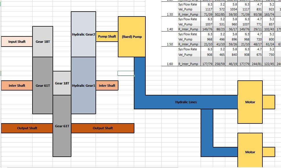

  • #45
Here's a schematic of my idea. No clutch yet, I want to avoid that if possible. The input shaft is connected to the CVT, which is connected to the engine. imsge1.JPGSo if I'm understanding this correctly, within a certain vehicle speed (say 0 mph, and 10mph, 10mph is arbitrarily picked in this case where that's the minimum vehicle velocity before pump shaft begins to rotate at the minimum RPM), the front two motors will work against the vehicle's acceleration, but the pressure should begin to build up rapidly within 0mph, and 10mph?

It depends on whether your rear wheels spin during the start, and the design of the pressure compensator feedback control system.
Why not drive the hydraulic pump with a belt from the front end of the motor?

What if I modified the system to use chain drive, so that the gearing between the engine shaft and pump shaft is almost 1:1 so that the pump is always spinning with the engine idle? But that'll cause more issues if I'm stationary, the pump will be trying to run the motors but my brakes will prevent that
  • #48
The engine speed is 1800 – 3600, the pump maximum is 1700, so you need a drive ratio of 1700 / 3600 = 0.47;
It can be done with a V-belt that will absorb shock and slip if needed. Roller chain is a more expensive solution. The pump may need a shaft support bearing to counter the side force of the drive belt.

  • #49
I guess it sounds like I'll need to find a workaround for the pump's minimum RPM right?
It appears that running the pump at lower RPMs than recommended will quickly shorten the pump's lifespan.
Edit: I'll do a 180 on that. I can't find any literature about this, so I'll figure it out myself and implement it on the gearbox anyway, since I'm expecting to run the pump within it's normal working conditions 90% of the time.
