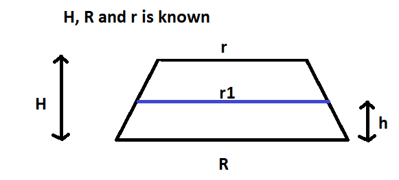

Hi,
Suppose you have a truncated cone filled water with the lower radius being R, and upper r (R>r), and the height is H.
R, r and H is known so the volume, V, can be calculated using V=1/3*pi*H*(R^2+R*r+r^2). Now suppose you remove some water so that you end up with a lower volume, V1.
The water surface will now have a radius of r1, and the height will be h. The overall shape of the cone will remain the same though, its just that the surface has moved down.
How can I calculate the new height? I cannot wrap my head around this. First I just used the new volume in the formula above and solved for H, but then I realized the upper radius isn't the same anymore, so that wont work.
I attached an image to illustrate.
Thanks!

think about how the radius of the cone changes with height.

I think I solved it.
The ratio, C, between the H and R-r must remain the same for the new cone (because the angle is the same, tan (angle) = constant) , so C = H/(R-r) = H1/(R-r1) => H1=C*(R-r1) [1]
V1=1/3*pi*H1*(R^2+R*r1+r1^2) = 1/3*pi*C*(R-r1)*(R^2+R*r1+r1^2), where r1 is the new upper radius, V1 is the new volume. Solve for r1 and then use equation [1] to solve for H1.

Your method should work (I haven’t tried it) but it looks like you will end-up having to solve a really messy cubic equation in ##r_1##.
Here are some hints for an alternative approach.
With conventional notation, the volume of a cone is ##V(r, h) = \frac 13 \pi r^2 h##. The difficulty here is that ##V## is a function of 2 variables, ##r## and ##h##. In your question, the cone angle is effectively given; this gives a simple relationship between ##r## and ##h##. You should be able to show that ##V(h) = kh^3## where ##k## is a constant. ##V(h) ## is now a sinple function of the single variable ##h##.
(You have enough information to find ##k## and the height of the ‘full’ cone in terms of the given data.)
The required frustum is the part of a full cone which remains after the cone’s ‘tip’ (itself a cone) is removed. ##V_{frustum} = V_{full cone}~-~V_{tip}##.
Using the above gives a more manageable way to find '##h_1##'. But it’s still a bit messy.
