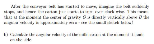

Calculate the angular velocity of the milk carton
In summary: Thanks for the help. In summary, the homework equation states that the angular velocity is 9.15 rad/s.

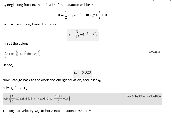

Is it correct?
javii said:
Is it correct?
No. You need to use the moment of inertia about the corner of the carton and you need to find the correct height of the center of mass when tipping occurs.

So, the formula i have to use is:
1/3*m*(b^2+l^2)?
and when i use that one i get
which leads me to:
so the angular velocity is 9.15 rad/s ?

Why are you dividing the 0.195 by 2 but not the 0.07?
javii said:
which leads me to:
And why do you think the CM is at height ##\frac{0.195}{2}~m## just before the carton tips over? That's its height when the carton sits flat on the conveyor belt.
For me, it is obvious that I have to divide 0.195 with 2, but I am not sure if 0.07 also have to be divided with 2 since the carton is
skewed.
So your are saying, that I also have to divide 0.07 with 2?
Yes, but it is important to understand why. Start with ##I_{CM}=\frac{1}{12}M(l^2+a^2)## and apply the parallel axes theorem. Try using symbols, not numbers. What do you get?

I_p= 1/12M(l^2+a^2)+M+d^2
I_p=1/12M*l^2+1/12*a^2+M+d^2 ?
I see, it is a mistake by me. Its just the height.
I assume you mean Md2, not M+d2.
What is d2 in terms of l and a?
Thanks
So what do you get now for the vertical displacement of the mass centre?
